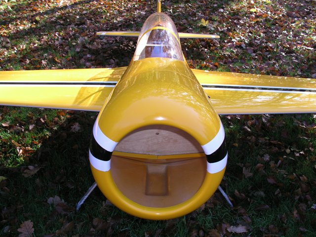

Hi Pe and Janch what is the length from the drive washer to the end of RE3 pipe or canister.
I would like the 80 with pipe in our Krill SU-29-33% but I'm not sure it will fit.
I'm also a little concerned about vibrations. I surely have to reinforce the firewall because
its only a big flat ply. Its our first big single, only had big twins before.
//Lennart

Hi,
I do not have exactly numbers / size/
Canister incl header is 460 mm +- 10 mm.
Is relevant info for you ?

Lennart,
The tuned pipe dimensions for MTW RE3 (in stock )are on my web page. A lot depends on how you configure the header.
I ran the engine with 350mm header length ( 14" ), Response was crisp and typical for a header that is too long, which is what is best for aerobatics. With that setup, I had 11 hp at 7100 rpm. These horses mainly are available for accelerating the prop.
The way you bend that 350mm into shape of course defines your total length. Best solution would be to leave a lot of tunnel length available behind the pipe so you can experiment, and cover it later with clear cote for aerodynamics.

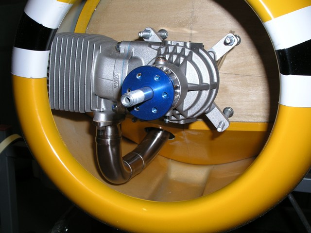

Just some pict of pipe inst Krill SU-29.
14" header RE3 pipe.
Not soldered yet and no pipe support
Problably building box for engine instead of 70mm long standoffs.
/ Lennart

That looks like a nice setup. I hope you do not fit a 24x10x3 prop on it like I did. It rips.
