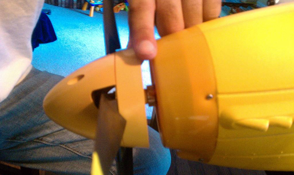

HI ALL I'm new to the planes and I order this from nitroplanes and i have this big gap in the front about 1/4th of an inch. I want to send it back to nitro planes but i already put it together. Other member pictures i have seen they are not like this. Will someone from nitroplanes help me out and send me a new one or let me know what to do. My order number is order yhst-17210252890263-151069 anyone from nitroplanes can call me at 216-315-5777 how come everyone else gets the perfect model and i get the hand me downs

No big deal...
Unscrew the grub screw holding the prop shaft onto the motor shaft.
Then slide the prop shaft back further. If this is not possible, use a drill bit to clear a bit more material from the prop shaft.
The plane flies just fine as is, provided the shaft is locked down well.
