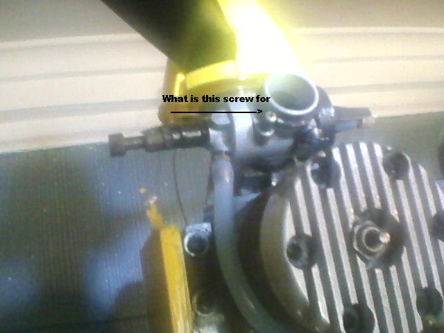

What is this small spring tensioned screw for? It is on the same side as the high-speed mixture valve, the other side is the low speed mixture and barrel valve stop.

That screw holds the throttle barrel in place.
It protrudes into the grove in the throttle barrel. It can be used as an idle stop as well, to prevent the throttle from closing completely.
Since we normally DO NOT want this, people unscrew it out slightly to permit the idle to close fully.
