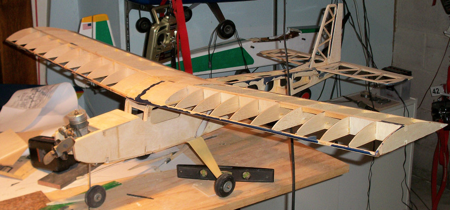

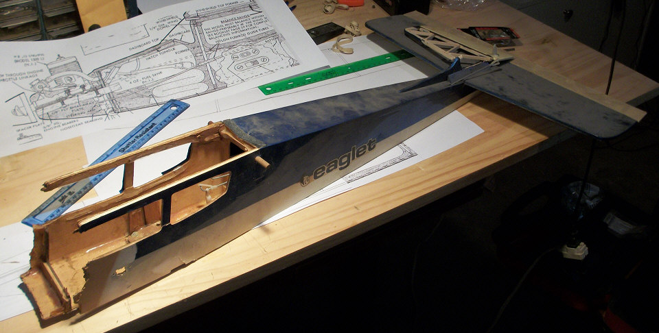

Assembly is easy. Balsa is an easy wood to work with, comes together with any aliphatic resin (carpenter's wood glue, Titebond's the best) for most assemblies, epoxy (I'm partial to 5-minute) for high-stress areas (motor mounts, landing gear mounts, wing joiners). Many modelers today (me included) prefer cyanoacrylates (CA glues - usually refered to as super-glue) and they're great but you need to have some air movement because of the fumes - they'll burn your eyes a bit. Most common "local" source for decent/good CA is (believe it or not) Wal-Mart, in the crafts department. Look for Titebond professional liquid (blue bottle) - it works well enough that I'm using it to restore a 40-year old plane trainer that crashed some time back. She's nowhere close to finished yet but here's a pic of her when I started and a pic of her just before I put the radio back in:

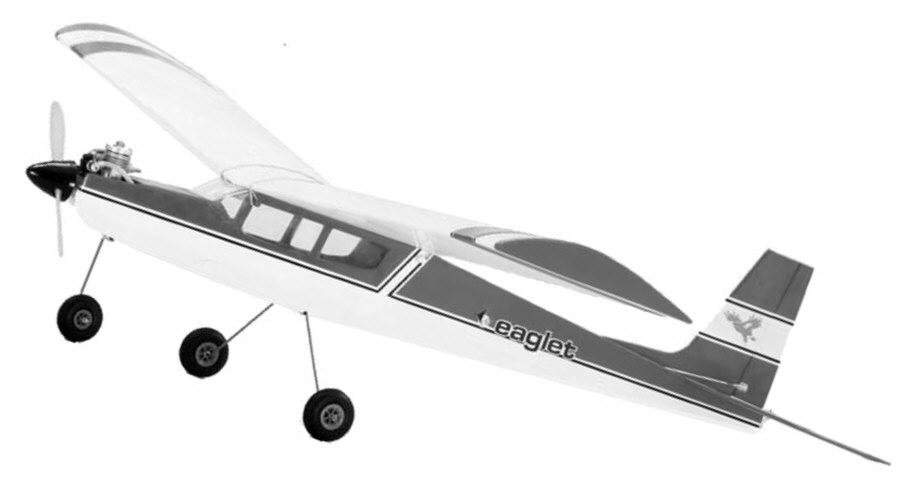

She's still got the covering to go on and the engine compartment to finish out but at this point she's about 30 hours of work short of flying. By the way, this is a trainer - high wing for stability, average power, low-average performance, rather easy to fly under most circumstances. Looks like this when finished:
Your plane, underneath, is not all that much different from this one. Just follow the instructions as to which part to put together first, and follow the steps.
