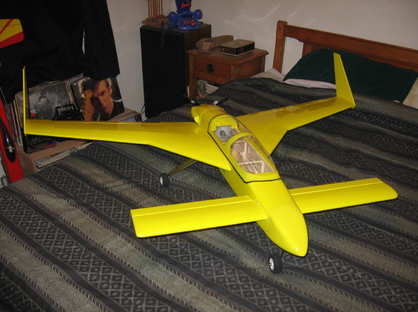

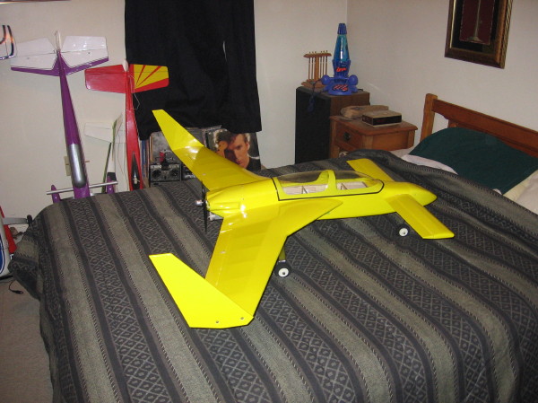

Here is my conversion
E-flite 46bl, 4400 lipo, 60amp esc, 12x8e prop
this will be one squirrley plane!
make sure you get airmovement over esc...or get way hot.
dont forget...elevator up is down...down is up.
I did not put in any thrust..I will see how bad it is needed after 1st flights. Easy to do, I can just shim the standoffs.
Vertical uprights are weak..Reinforce with some angle stock or carbon.

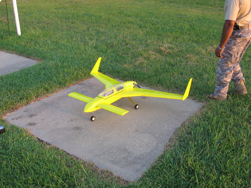

I'm currently flying the yellow version of the Long-EZ 46 with a Super tigre G45 ABC engine with the stock "barrel shaped" muffler. It is PLENTY fast, slows down to a nice slow flight, landings are with long approaches but are not fast. Few tips---set the plane up so the front is a bit higher than the rear. This will give a bit of positive incidence in the canard and it will fly right off the deck once the speed is up, vs. having the plane sitting level or nose down where the canard is "plowing" on the take off roll, you give it up elevator and it is going to LEAP into the air--probably with a resulting stall to end your day. As soon as you touch down on the landing get OUT of the elevator, or else you'll probably be flying again! CG as spec'd seems to be fine balanced empty with NO fuel.
Ahh, but you guys were trying to figure out a way to mount the canopy for easy access. On the 46 size model I'm simply using 4~ 4-40 sheet metal screws at the corners of the canopy after I applied a piece of rubber "canopy trim" stuff that is like a weatherstrip around the trimmed canopy.
So here is the suggestion for easy access via the canopy. First, fit a piece of balsa inside near the front of the canopy that you can insert a couple of dowels. Fit a piece of balsa with holes to receive the dowels into the plane. At the rear of the canopy, fit a balsa "strut" across the canopy, CA a small piece of plywood on the top of the strut in the center, screw in a J hook to the bottom of the strut and up through the plywood, cut a #64 rubber band, loop it around the wing joiner tube, tie it in a knot and then fitting the front of the canopy into place on the plane then fit the rubber band through the J hook and "Voila"! there you have it!

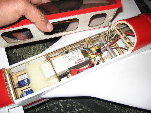

Kind of like this one on the little electric Long-EZ that I also put together.....

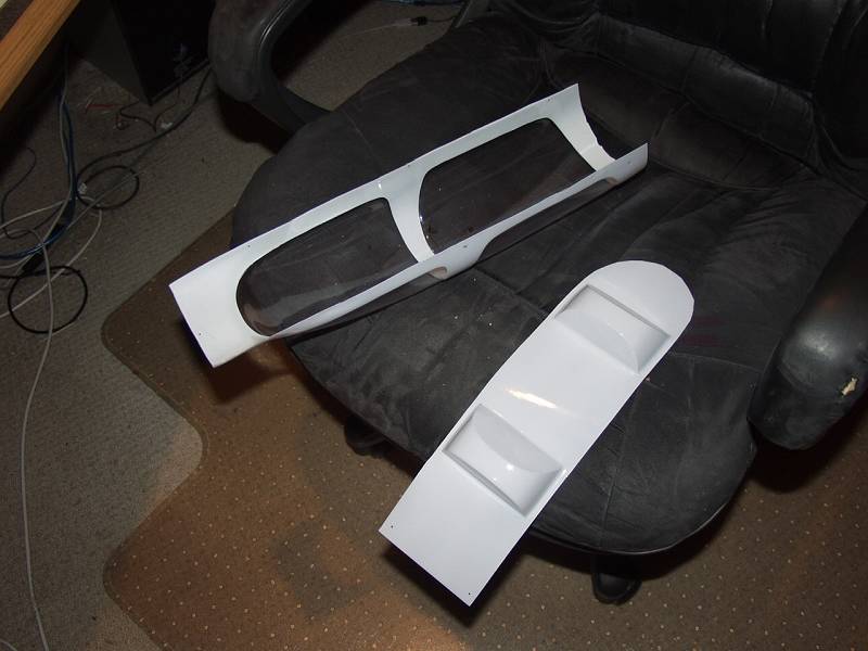

Thanks for the info on cg and incidence..as far as the canopy, this (nitroplanes) version does not that nice sub-frame you
have so unless we built one..its just a piece of flimsy plastic to try to attached. How did you make the front taller?? bigger wheel, change motor mount?
Here is photo of the canopy..any suggestions??

That's the same canopy I'm working with. It will take a lot of time and craftsmanship to create an entire frame for it. I was thinking of 2 ideas (or a combination of both). Either strategically placing heavy duty velcro strips or (better) I was thinking of attaching thin strips of wood or plastic on the inside of the canopy along both sides each with three 1/2" holes positioned front middle and back. I have on order thin 1/2" disc rare earth magnets that I would epoxy in the holes. I would also mount magnets on the fuselage in the same positions. Possibly add velcro at the middle front and back locations. All of this is still in my head at the present time. I haven't decided which path I will take. I know I don't want to use screws. I will need fast and easy access to the 14.8V 4000mAh Lipoly I will be using. Since the RichModel Long-EZ 46 is designed for glow power, converting it to electric takes some ingenuity and patience!

Magnets, velcro, tried both of those with the little electric Long EZ with the frame in the canopy. It was already doweled in the front, just a quick way of holding it down at the rear was the challenge. The rubber band around the wing joiner tube to the J hook, in my opinion, is the easiest, simplest and most elegant design (unlike the usual Rube Goldberg!).
I realize your canopy is just a floppy piece of clear plastic. I've got the exact same canopy on the yellow 46 size Long EZ I posted a picture of---for mine, with the nitro engine---it's simply held on by 4 screws at the corners. As for the plastic cover with the seats or instrument panels or whatever they are supposed to be.....it's still in the box.
So lets think along these lines.....say you take that floppy plastic canopy and with your reading glasses under a good light take a CLOSE look at that canopy. I bet you will find a very fine molding line that is curved around the front of the canopy, even and straight down the length of the canopy probably about 1/4" up from the edge of the canopy, a curved corner at the lower rear of the canopy, and finally the molding line goes up and around the rear of the canopy. Look close, you will see it.
You found the molding line. Now find some masking tape and tape along the bottom line on both sides of the canopy as a guide. Use a straight edge and an Xacto knife and cut along that line. Mask the curved portions and cut them with a pair of curved scissors. About $15 or so for those scissors if you don't already have a pair but worth every penny if you are going to stay in this hobby.
Using the silly plastic cover headrest/seats doo dad whatever it is as a template, cut a piece of say 1/8 light balsa the same size to use as your canopy frame. Make a pair of semi-circular pieces for the front--one for the plane and one to fit inside the front of the canopy atop the balsa sheet frame where you can dowel the both of them to secure the front. Put a piece of wax paper over the opening in the fuselage and down the sides a couple inches. Put the plywood and J hook into the balsa sheet frame at the rear and attach with rubber band to the wing tube.
Clean the canopy with alcohol and paper towels. Like REAL clean. Apply a bead of canopy glue to the balsa sheet frame and around the top of the semi circular front piece with the dowels, lay the canopy onto the plane and once it is fitted correctly tape it down good with the masking tape, and after 24 hours for the glue to cure you have it done.
Here is a couple pictures of mine that should give you an idea of where to look for the molding line as this one is trimmed along that line---with the exception of the lower rear corners where I left it with a 90 degree angle instead of the curved corner.

Here are some images of my Long-EZ and electric equipment just waiting to be assembled. The first image is the RichModel kit contents (minus the canopy). I forgot to include it in the picture. It is the same design that bobz pictured in a previous post. The second image is the power equipment. All components were recommended by Hobby Lobby's glow to electric conversion department. (See their website.) Equipment includes: AXI 2826/10 OUTRUNNER Brushless Motor, Jeti Advance PLUS 70 Amp Opto Brushless Controller, Ultimate BEC, 11x8.5 APC Electric Prop. (Not shown: PolyQuest "Twenty" 4 Cell 14.8V 3700 mAh LiPo Pack). THe thrid image shows the manufacturer's attempt to run tubing for rudder push rods in the wing. (One wing has the tube the other doesn't.) No other components (vetical stabilizers) show any intent to include rudder so I guess they initially intended to have this control but decided against it. I was going to try to add rudder to my build but have since changed my mind. The forth image shows one of the wing servo bays that I have reinforced as recommended in an earlier post. (I think Rube mentioned to do this.) I will continue to post images as the build progresses.
