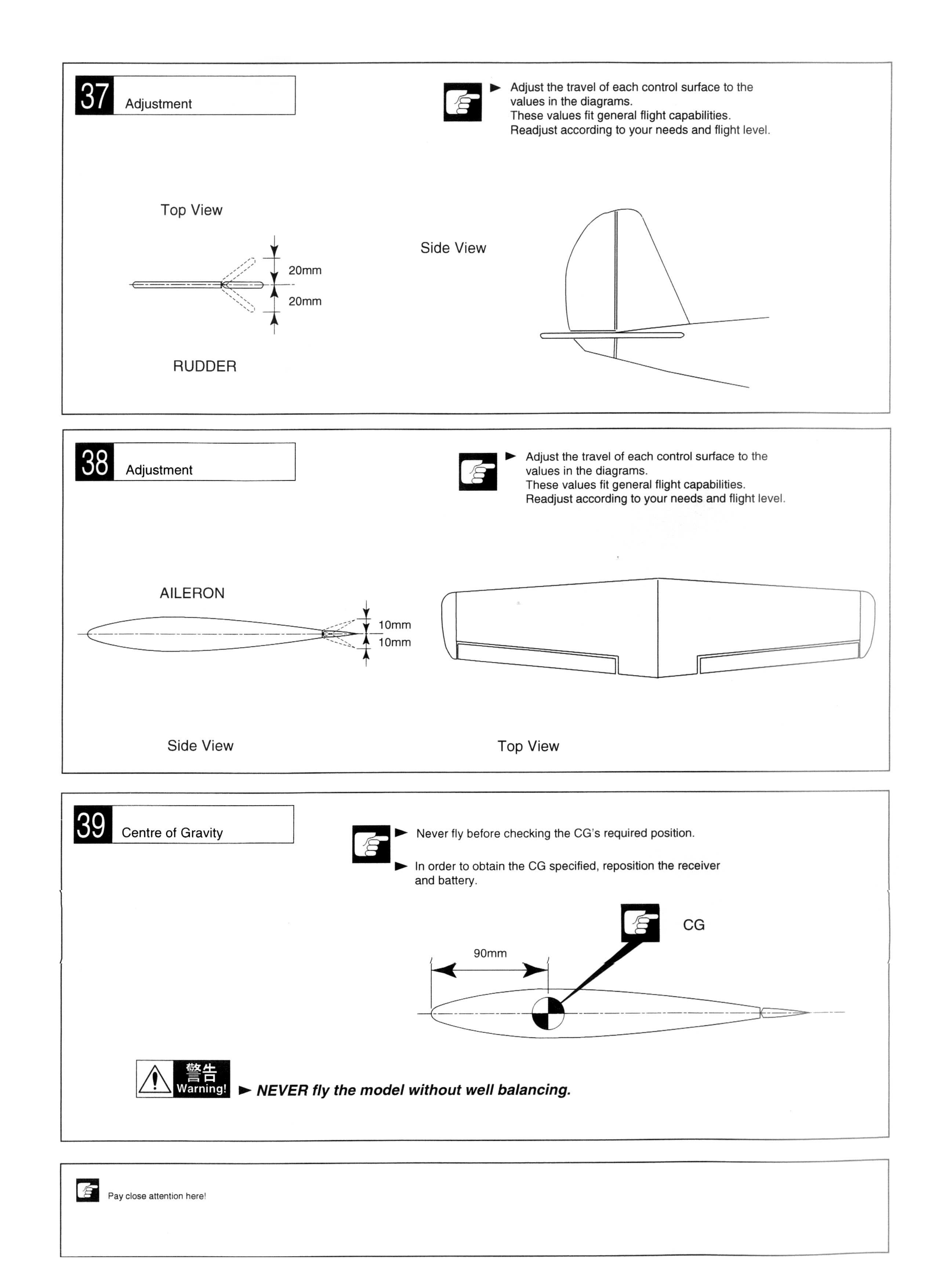

Can sombody at Nitromodels tell me where the center of gravity should be on the Ryan PT-20 ARF?

Posted is a copy of the manual with the CG information.

Thanks for the info wu1chef

Make sure to double check all CG's here. Alot of times thay are wrong in the instructions
http://www.coloradogliders.com/cente...calculator.htm

Like Gotsky said, better safe than sorry.
Always err on the side of a nose heavy plane.
