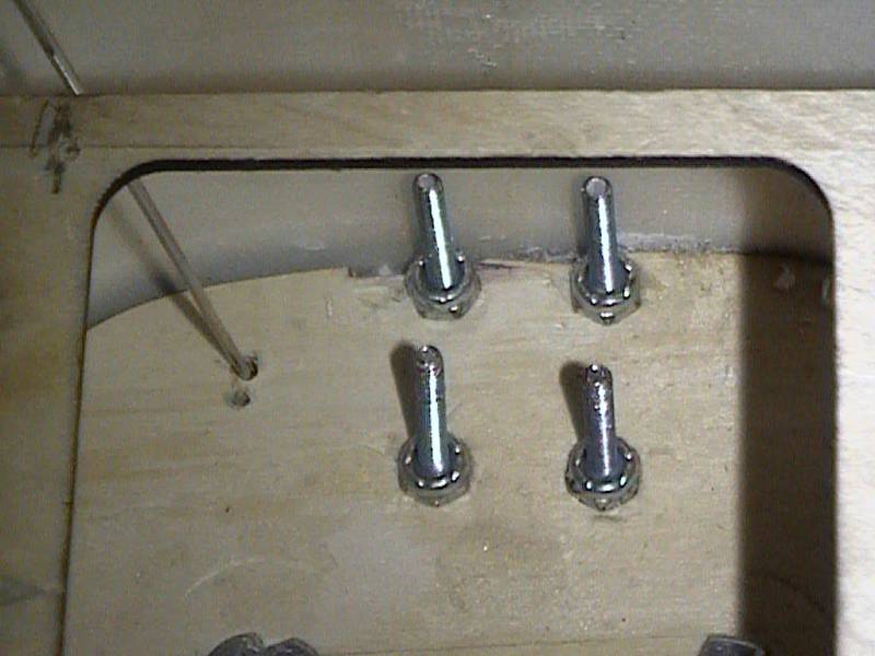

Well, I can tell you that it's not a beginners ARF to put together. I had to re-do a few things my way. The tail section was not straight. So, I heated it with my heat gun and straightened it out. That took some doing. Hope yours is straight. I think it's a poor design to boot. It should be a one piece bolt on low wing design instead of plug in wings. The wing bolts are very hard to get at and you have to remove the canopy to even get to them. But I think we can't expect perfection for the price of $125! I have several flights on mine. It does pretty good, I think. It has a Saito .82 with 12x6 prop. Yep, it is pretty fast. But it slows down very well for landing. I might try more pitch on a future prop for a little more speed. Good luck with yours. I think you'll l ike it.
John

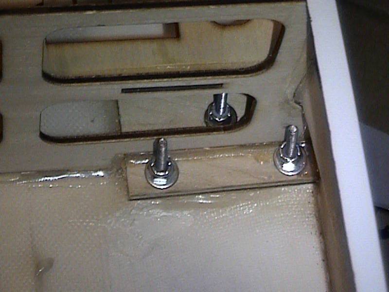

I am building this plane as I type, just wanted to know if you epoxied the main wings to the fuselage ? In the instructions it says to connect the wing with bolts then epoxy .
CAP
Old 03-12-2008 | 11:19 PM
Joined: Sep 2003
Posts: 173
From: Santa Rosa, CA
Default RE: Aquila AT01 ?
No, I did not epoxy the wing to the fuse. You would never be able to take it apart for transport if you did that. That's one thing you have to watch for with Nitro Models, their instructions aren't the best. They need a new translator. That's why I mentioned that this is not a biginners arf. Some things you just have to figure out for yourself. So, hopefully, you have a few arf's under your belt and just build this one as you see fit. Like the instructions said to use only one servo for the rudder and nose gear. But that would have made for some funny bends in the linkage. So, I used two servos and two channels on my radio to make that work. And instead of two servos for the elevators, I used two 440 rods, one bent to the other just before the servo and soldered together, for elevator control. And I took out their control linkage guide tubes, cut them out of the bulkhead and re-routed them so there was no bind in the middle. As you can see, they had them all in one bunch in the first bulkhead. That caused a lot if binding. Take them out, cut the bulkhead braces, put them back in with no braces, then make your own brace and glue them back to the bulkhead. I just took a picture, but I'll have to put it in the next post, as I don't want to re-type all this. Hope this helps. In the pic you can see the two elev. rods on the left soldered together and the rudder rod on the right.
Good luck-I think you'll like how it flys-but it's a lot more work than most arfs.
John

OK-here's the picture I took, hope it helps.
John

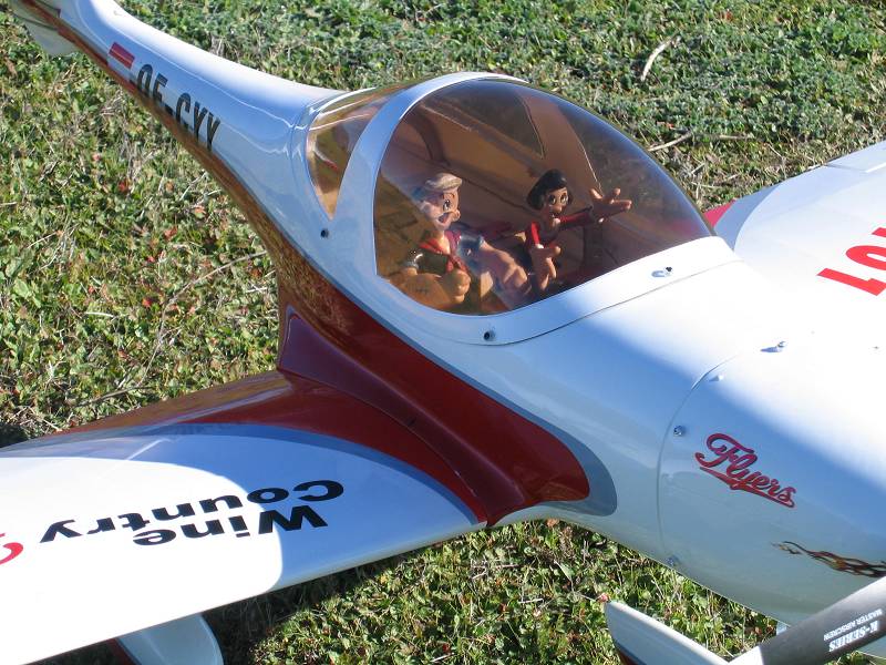

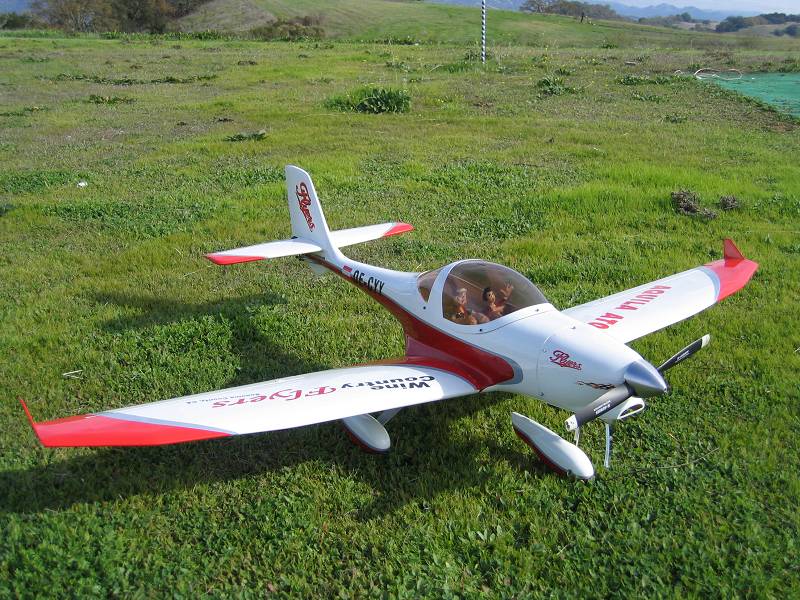

Just went back out and weighed it. All up weight, 7 lbs. 9 oz., with Saito 82 (no muffler-instead it has Saito 90 degree adaptor with Saito flex pipe) 12 x 6 MA prop, 2 1/2 in. Tru Turn aluminum spinner, JR 2700 NMH bat., 6 servos, and of course as you can see in post #4 Popeye & Olive as pilots. Yea, I know, he's a sailor man, but they were just begging to go flying !! Let us know how it flys, and your specs, as in weight, what motor and such.
John

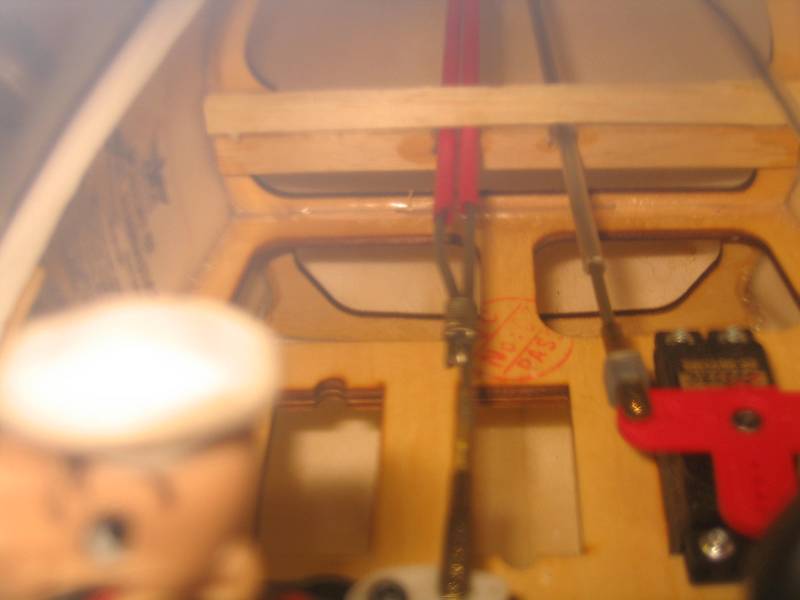

Thanks for the info WCF. I completed the main wings last night. For a Nitro Models plane I was very impressed about the servos being mounted in the wings. The hardware alone makes me believe NM is trying to do better with their ARFs. As far as the elevator installation, I always try to use two servos when ever possible, so I will probably use the tubes provided in order to keep the link between the servo arm and elevator horn as stiff as possible. This is my third NM ARF plane I am putting together , so the poorly written manual has no effect on me.
I plan to use a ROSSI .60 on the nose, why ? because it doesn't have a plane to go into. I recently changed the bearings in this engine and flew only 2 flights before dead sticking to a crash, so I am anxious to see how these sealed ceramic bearings hold up. I will continue to post information and pics in this thread if you don't' mind. I should have all the control horns and servos installed by Saturday mourning. I want the maiden flight to be on Sunday . Oh yea I am ordering a on board glow driver and if the weight is right a smoke system. I recently put together a THUNDERBUG 1.20 ,(hand me down plane for $20) with a Zenoah 20ei on the nose , so eventually I will be putting glow planes on hold as I get into flying more gassers. The point I am trying to make is I want to try everthing with glow before completely switching to GAS then eventually electric too.
CAP

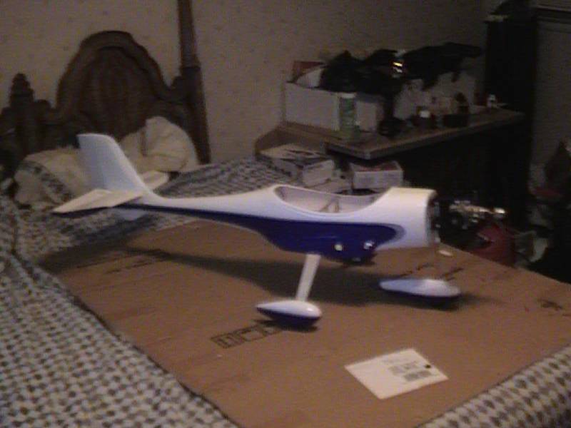

Just a few progress pictures . If you notice, I used lock washer nuts on the landing gear nose bracket and the landing gear mid fuselage. Another tip was using the U-clamp to press the engine mount blind nute into the fire wall. On the tail control surfices I angled the control horns for better movement of the control rods. I have to mount he servos, set up the receiver, cut the cowl ,and mount the canopy, before knowing the AUW.
CAP
