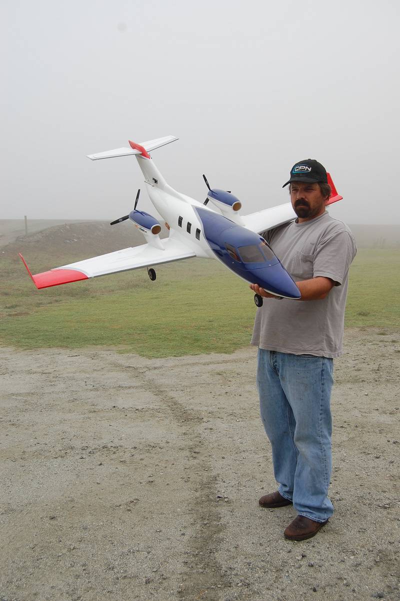

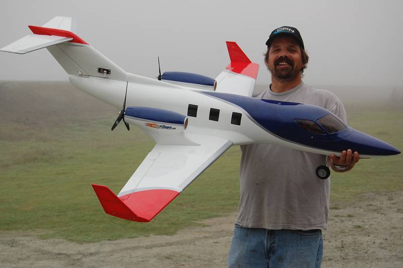

7.5 lbs. rimefire 35-36-1200 x 2, 70 esc x 2, maxamps 4cell 3000mah x 2
44 amp 630 watts per motor on 9x9 apc 2 blade props,1200 mah recv. pack
fiberglass work is top notch well done again.MAXAMPS AND NITRO MAKE A GREAT HOBBY BETTER

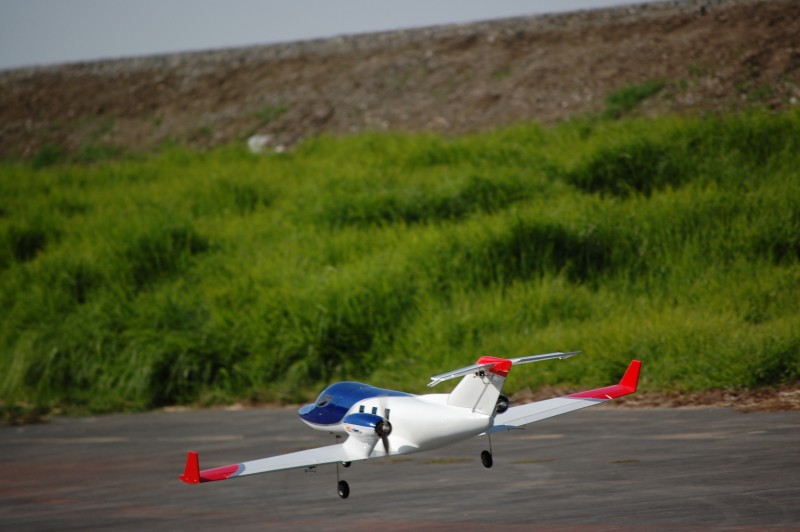

DONT LET THIS ONE SIT ON BENCH.MAIDENED TODAY AWSOME SLOWS GREAT ON FINAL HAULS BUTT AT FULL THROTTLE.C.G. IS CORRECT.PWR SET UP I USED COULDNT WORK BETTER.I'LL POST PHOTOS LATER TODAY.NITRO IS ON A ROLL WHAT NEXT.ELECTRIFY 90 INCH P-38.HONDA IS A MUST HAVE DONT MISS THIS GEM.

In case anyone is paying attention:
Gardenia's power set up is:
rimefire 35-36-1200 x2
maxamps 4 cell 3000mah x2
towerpro 70 amp esc x2
apc 9x9
recv pack 1200mah
test were static 44 amps 1230 watts roughly,flew maiden 6 min
