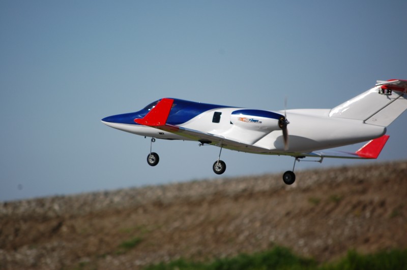

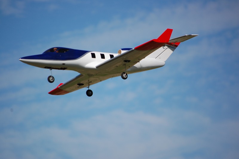

Default maiden
hope you can see honda[img][/img]

Lookin good[8D]!

Could you post what items you put into the plane?
e.g. all of the electronics, etc.
Thanks.

looks nice,
I don't know that plane what size and specifications? please take me some info about this plane (size, weigh, motor size, radio gears etc...) where can we find sellers or plan ?
best regards...

rimefire 36-35-1200 x2
maxamps 4 cell 3000mah x 2
tower pro 70 amp esc x 2
apc 9 x9 x2
recv pack x 1
44 amps static
1200 plus watts
7.5 auw
plane is great slows to a crawl.also nitro has great models plus user friendly prices.hope my info helps.rick
