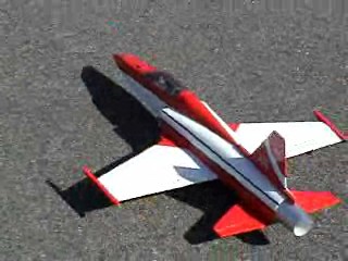

I got the TigerShark from nitroplanes. I have flown jets before but never put one together. Any ideas which edf unit and motor to use in this plane.

Back to the original topic....
I will try to help although I don't have this jet,
this fan:
http://www.hobbycity.com/hobbycity/s..._7_Blade_3inch
with this motor:
http://www.hobbycity.com/hobbycity/s...hless_Inrunner
should work great with a 4s1p lipo with a capacity of at least 3000 mAh
Just check to make sure there is enough room in the fuselage for a 3" fan. If not, I would suggest a Minifan or HET fan with a Typhoon 2w20 (that's a perfect match for sure). It's a little more expensive. Those are available from Electric Jet Factory in the USA.

i ordered the f 20 tigershark.
the het 2w20 with the 6904 fan unit and a tusnimie 72 amp speed controller. bought from
the jet factory came as a drive set, all three items for under 150 dollars. its a great set up i am useing a 3700 mhp 4 cell lipo battery.4 digital servos. since i used a 72 amp esc i didnt need a BEC
