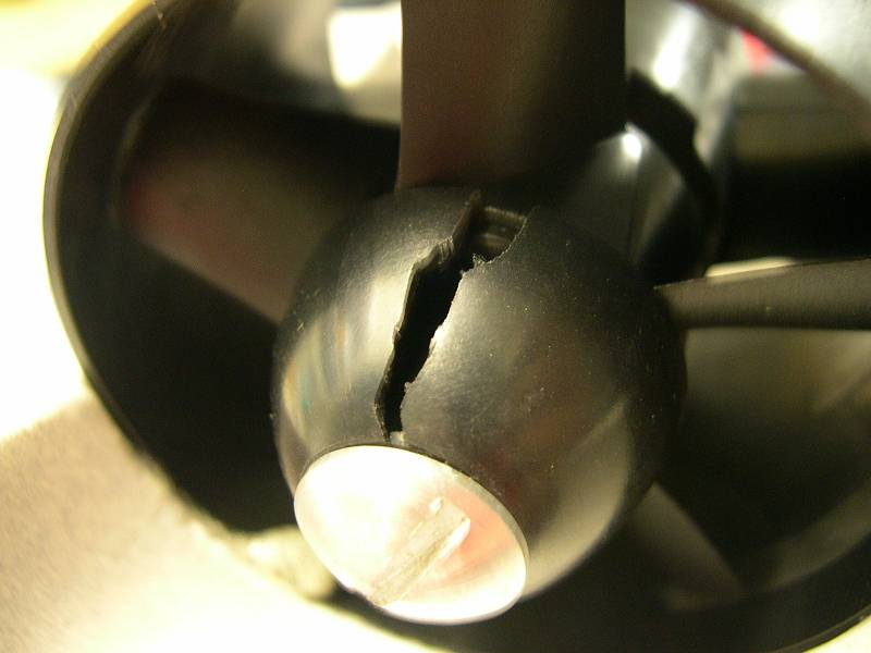

Do you have it perfectly centered?
Balancing a small fan can be unnerving as it is difficult to find the heavy or light side.
I sometimes put a marking pen lightly against the turning hub.
The side that gets the most mark is the "heavier" side, so I add weight to the other side.
But getting it centered is critical.
If you got the fan up, did you check the retainer as well?
Try spinning the motor with the retainer on it w/o the fan.
Run it up briefly.
It should be fairly smooth if the retainer is not unbalanced. Also check for lateral play on the motor.

I charged both packs on the included charger. The first pack, the replacement pack, charged in 1 hour 50 mins @550ma. The second pack, the pack included with the F-35, charged in 1 hour 20 mins. Do they ship them with some charge? After that charge, the green light never went off. When I plug in the AC or hook it up to the car battery, both the green and red lights go on.
I centered the fan. How tight are the cones supposed to be? I'm spinning the hell out of this thing, but when I put take on the back of the light blade I still can't seem to get it to stop vibrating on the drill. ACK!
I'll check the retainer. I'm pretty sure is has a bit of play in all directions.
As it spins check the edges of the blades, if you see a blurry back and forth movement, then they are not centered.
I'll bet that is your problem.... or maybe your drill is not balanced... try running it up w/o the blades... also run the spindle by itself..
Did you obtain the prop balancer?
That is why I recommended that you get one, as this helps assure the fan is centered, though you must have the two cones facing the fan.

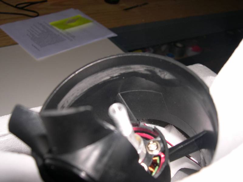

I did purchase a balancer and I am currently using it. When I spin the fan on the balancer, it wobbles, but I just thought this was because it was out of balance. It's because it's not centered property? I will try to center it perfectly.
I am confused as to what the retainer is , I think. Is the retainer is the piece in the engine that the fan slides onto? Was I suppose to remove it and place that in the drill with the fan attached? As of now, I am putting the balancer rod in the drill and spinning it.
There is a grub screw holding it in place.
If you recall I mentioned that you must drill a small hole in the EDF "ring" to permit you to push a hex key into the grub screw to remove it.
Do so and remove the retainer.
Put BLUE locktite on the grub screw and put it on the retainer loosely. Put the retainer back on.
Notice that one side is flat...on the motor shaft... the grub screw goes against that...
Tighten the grub screw and there should be NO PLAY on the retainer, other than the movement of the motor.

Both lights turn on without the battery being attached regardless of the power source. They both turn on when I use the AC or when I use the car battery. I think it's defective.
The cones are both taught against the fan. When I spin it, looking at the inside of the hub, it is wobbly. I'm just having a tough time balancing it.
I was incorrect when I said that there was play in the retainer. There is not. There is, however, play in the thinner motor shaft.

You may need to find a bit or some other tube that fits the inside of the fan snugly to prevent the wobble.
Re: Play
The shaft cannot really move, other than in and out, as it is held by bearings.
If there is side to side play, then this might be the entire motor in the edf itself... Did you tighten the motor's retaining screws?

New airplane version - But I had the same problem.
Looks like they test ran/broke in the EDF at the factory - I have not even put the battery in it yet.
However, the fan will need some work (and parts) before it will fly..
Is there another part that will fit in place or replace the spinner???
