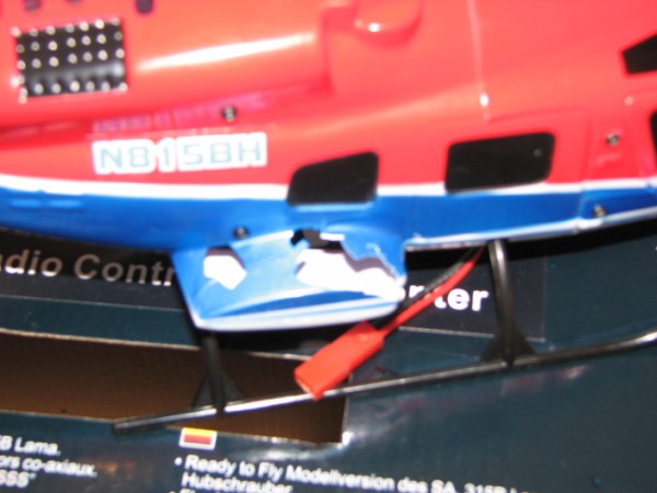

Received damaged
Joined: Jan 2010
Posts: 5
From: Green Bay,
WI
<style type="text/css"></style><div>I just received my RC helicopter,http://www.nitroplanes.com/new20airwo4c.html, Order Number 733175, and found damage while unpacking. Please see the pictures. Also just wondering why this is in a BL-V box with Lama 5 instructions?</div><div>Thanks,</div><div><font face="Arial" size="2">Dave Worthen</font></div>
