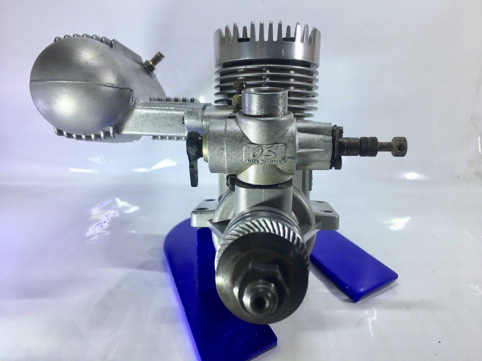

I picked up a used OS 61 MAX SF. There was a window of time, back in the day, when OS was a KILLER model engine. It was the top dog in my neighborhood. I LIKE it!
1986
