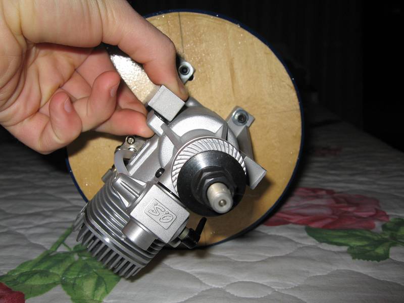

Old 01-17-2006 | 05:38 PM
Kostas1's Avatar
Joined: Dec 2005
Posts: 3,566
From: AthensAthens, GREECE
Default RE: OS 91FX 2 Stroke
Ηι there!
Just got my NIB OS 91 FX!
You will not have any problem with this engine,if properly used!
Enjoy...
ID:	389718   Click image for larger version
Old 01-18-2006 | 11:01 PM
baronbrian's Avatar
My Feedback: (13)
Posts: 890
From: Grand Forks, ND
similar to the 1.60 fx needle valve?
Old 01-19-2006 | 03:31 AM
Joined: May 2005
Posts: 27
From: New Delhi, INDIA
I checked it out and it looks like the same assembly as the one on the .46 AX.
