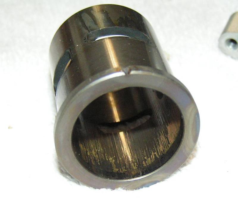

Here is a picture of the liner and I also have a question about the intake under the carb.
I'm new at taking engines apart and would also like to know the best way to get the crank and bearings out.

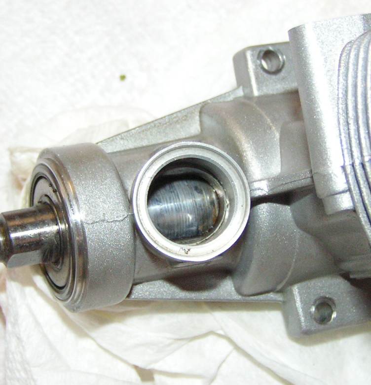

If you look at the picture of the intake, do you see the lines around the shaft? It looks like wear to me but I don't know if it's normal or not. This engine was run about 1 summer, maybe 3 gallons of Powermaster 15% through it, it was never wrecked. It got to the point it was more hassle to use than it was worth and I put it on the shelf.
Thanks for any help.
Bob Beatty
I finally got the crank out and the crank case is scored like the crankshaft (picture 2)

Old 07-23-2007 | 09:53 AM
Bax
My Feedback: (11)
Posts: 19,483
Received 8 Likes on 7 Posts
From: Monticello, IL
Default RE: OS .46 FX plating problem?
The scoring in the case indicates that the engine's ingested quite a bit of dirt. That's what causes the scoring of the case under the carb opening. That could also have started the cylinder liner's peeling.

Old 07-24-2007 | 09:50 AM
Bax
My Feedback: (11)
Posts: 19,483
Once the head and rear cover have been removed, the liner can be pushed straight up, out of the case. If it's a bit 'reluctant', you can heat the case a bit. With the liner out, the rod and piston will come out. Make sure you mark them so they go back the same way. With the rod and piston out, you can push the crank out the rear of the engine. Heat the engine with a heat gun, torch, or in an oven to about 250-300 degrees F. The bearings will fall right out.
To reinstall new bearings, heat the case and push the cold bearings into place. Slide in the crank and install a propeller. This will pull it all together.
