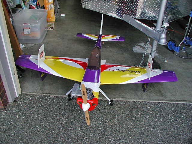

I Have 2 OS 46 FX's, 3 OS 50 SX's, 2 OS 55 AX's, OS 61 FX, OS 91 FX, and 3 OS 120 AX's. I run all My Engines on Morgans COOL POWER "Green Colored" 15% Nitro Fuel ONLY. NEVER use Other Fuels or Higher Nitro Content. I only occassional put some After Run Oil in them if I'm not going to run them for long while. I break all My Motors in the Way OS Engine Manual says and they All Run Super. Propping and running Slightly Rich like manuals recommends seems keep them performing better than other 2 Stroke Glow Engines. I Have allot Props in all different Sizes and Pitches. Propping How I get Better Performance out of My Engines. Experment abite and You'll be Happily Surprised. Also Your Engines will Run and last longer. The 120 AX with APC 16 X 4 Wide Prop works great on My 3D Airplanes. Use Tach see which slghtly rich gives close 10,000 RPM recommended RPM for that engine. They Lean some in Air And Turn More RPM. I think can Gain close 800 RPM More in Air with many Props. So I like set My 120 AX at about 9000 to 9500 RPM on Ground and in Air They Fly Supper with those APC WIDE BLADE 3D Props. Happy Flying. richgrow
