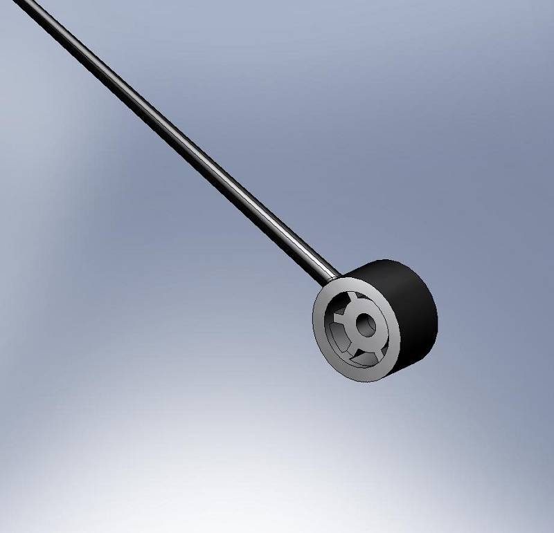

OK, Anyone got any advice or opinion on this? I counterbored the hub on a Master Airscrew 3-bladed 14x8. I did this to accomodate reaching in to a short shaft with the prop hub nut. Question is have I weakened the prop hub by cutting down into the "spokes" of the hub?? Here is what it looks like now.

If you modify a propeller, you can compromise its structural integrity. The counterbore can weaken the center because the full width of the blade would no longer be supported. We cannot advise such a modification.
Enlarging the diameter of the hole in the middle, though, is commonly done. With your engine, you may be able to use something like this:
http://www3.towerhobbies.com/cgi-bin...2934&search=Go
Perhaps one can be made.

Tried your suggestion earlier in the process.
1. Couldn't find a 5/16-24 thread nut.
2. After a spinner plate, prop and washer absolutely no crankshaft threads are available for a nut.
