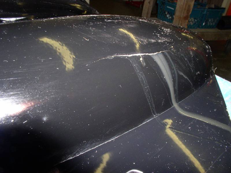

75 MPH in a 27' Concept...... just dropped out of gear....

got any other angle pics hard to see

better pic...

Ouch, that looks ugly.

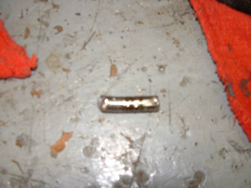

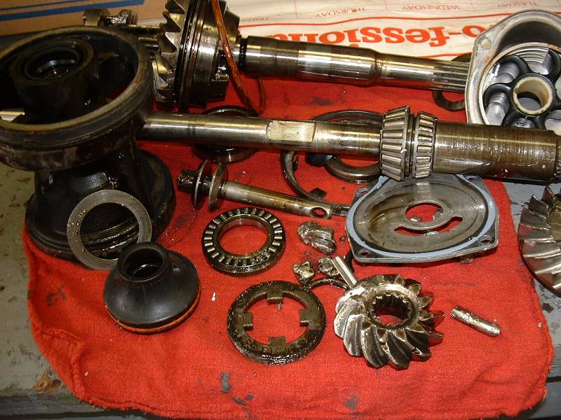

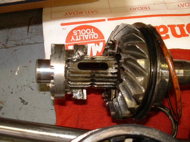

The spring unwound itself from the clutch dog and sent the cross pin flying. Damage was actually minimal.....new housing, spring and pin.

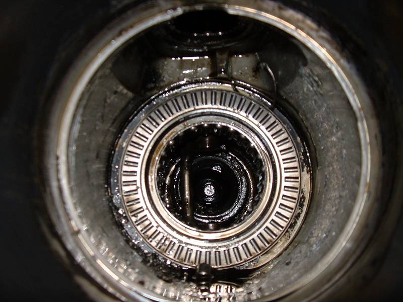

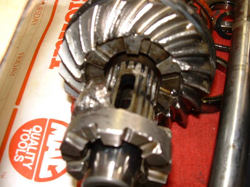

here are the guts:
