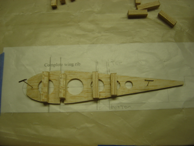

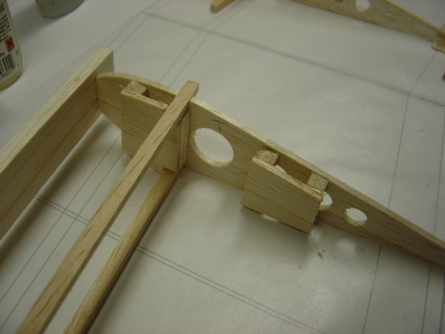

i have that question solved, but another has come up. how do i build the center strut tabs? they are shown in the instructions, but nothing is mentioned on how to build them.
Old 12-30-2005 | 06:17 PM
matchlessaero's Avatar
Posts: 1,288
From: Cordova, TN
Default RE: Boxxer Build question
Jason, build the center strut ribs over the alignment drawing on the plans. Then use some 1/8" scrap to box them in from the other side. Remember to do a left and a right.
The first pic shows gluing the 1/4" square stock onto the ribs per the alignment drawing, the second pic shows the boxed in ribs on the left panel.
(this is covered on pg 13 of the manual)
