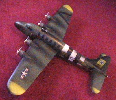

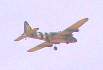

Here's a pic of mine in the air. After seeing what a big difference it made on my landing gear modded Twin Star, I am going to gear this one too. I am going to try the DD gws 7x3 prop for spd 400 first, but I will probably go for the GWS EPS 350 with ratio A and 8x4 props. They have slight overlap, but with the recessed pylons, it's not a problem. I'd rather have 60 + ounces of thrust instead of 32. You can throttle way back and really increase the flight time.
