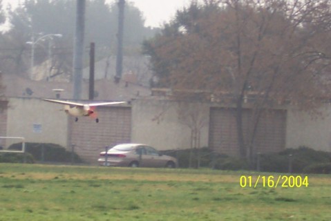

Glad it is flying.
Rascals are great, when they fly.
I fly a built up kit from Top Flight, 27" and weighs 5.4 ounces.
I love it. But no fun at all if everything is not right.
