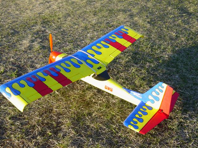

So I just just recently graduated from Slow Stick happiness and moved up to a GWS E-Starter. I took some time and painted it up all pretty and swapped the electronics out from my SS. I was a little nervous about flying her because it was my first aileron plane. (cough, cough - Liar) Ok I was scared to death of her. It did not help that they guy at the counter of my local hobby shop made a comment about how fast the E-Starter flies. So I waited for a calm day and took her out for a test flight. I walked out to the middle of a soccer field, cranked the throttle, made a nice hand launch, and was totally mystified! It flew straight and level without touching a single control! Now I may be new at flying but I KNOW that you have to trim your models. To make matters worse - the ailerons were not a problem! The plane went approximatly where I told it to go! Now I was smart and took my E-Starter to the recommended 3 mistakes high altitude before trying anything. The first thing I tried was to take it up to 5 mistakes high.
I found this plane to be utterly enjoyable to fly. In my first two flights I had only one mishap and it was easy to recover from. I think I went into a bit of a spin. Landings however were a little bit unnerving. Did I mention that the E-Starter flies much faster than my SS? I always fly until the motor cuts out and then make unpowered landings. All three landings with my E-Starter so far have been more like thumps then landings. It stayed on its wheels but it hit uncomfortably hard. Any suggestions?
Anyways - I took a picture of my E-Starter before I flew it (in case of an encounter with gravity). What do you think?

Nice looking plane!

your aircraft looks very well finished, really nice job.
