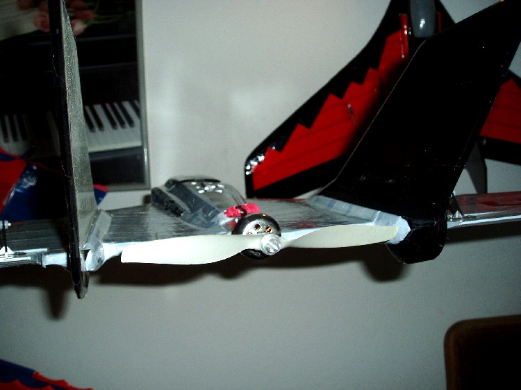

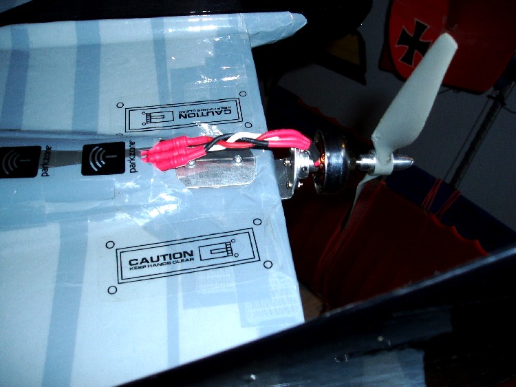

I have been kicking the idea of putting an outrunner on the stryker but cant come up with the best way to mount it????? can anybody give me an idea with a pic would be helpful too... also which outrunner& prop works well with a 3 cell lipo on the stryker???
And if you dont think the outrunner is a good idea let me know what inrunner/speed control is best without spending too much money. and can you use the stock mount with it.

How abot checking the Stryker Way past the limits thread?
A lot of outrunner talk and pics of mounts there.
BP-21 or TowerPro 2409-12T are good choices for 3S LIPO. I have epoxied a plywodd disk into the rear ring of the stock mount and bolted the outrunner to that.

Here's the BP-21 outrunner mounted with a 7X6SF prop. I may be selling the mounts soon.

all you could have done was out a circular wood block in the motor shaft the bolt the motor into the end of the wood very easy and el cheapo
