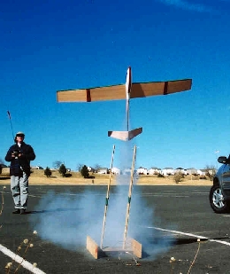

Been flying an Estes Sweet-Vee for years. Weighs more than twice as much as today's competition gliders. Sure attracts attention at the field.
