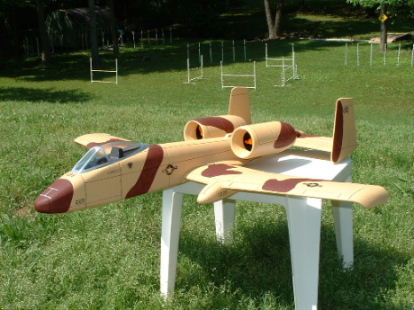

Here she is after first flight.Flew great for stock setup with no gear.

Hi,
Is this the GWS A10?
I'm thinking of buying this plane, can you tell me what it's like to fly? WHat motor & battery's do you use? Does it land OK without wheels? Can you do basic acrobatics with it?
Thanks for any info

Yes, this is the GWS A-10 , stock with EDF50's.They fly great, very easy to fly and stable, however this is not a fast airplane.I've flown it with the 6 cell 600mah nicad and the E-Tech 2s 1200mah Lithium pack.It will fly more than 12 minutes on that pack, but limit flight time to 6 minutes for motor cooling.Motor life is not good so make it easy to remove the cowls later.I'm using scotch tape on the inside of the cowl to hold them together, works great.Follow the threads on some of the little things you can do to increase the performance and keep it LIGHT!
It is not a aerobat, as stock, but some have looped and rolled her; power is marginal.
Lots of fun to fly and sound and looks good.
