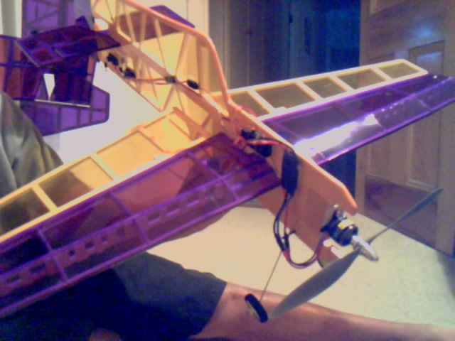

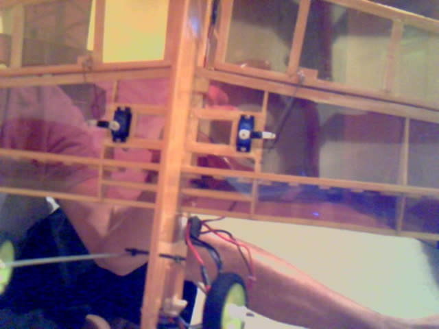

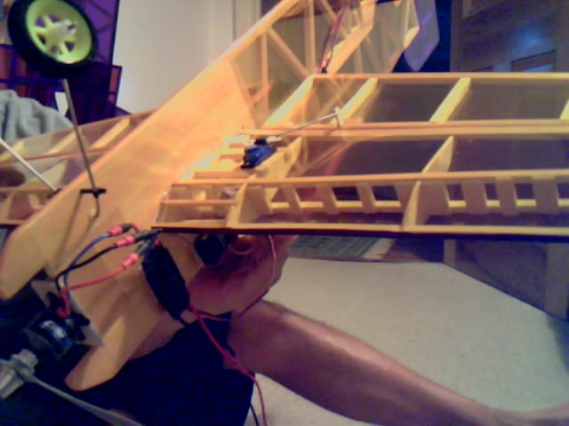

Hi this is my scratch built profile ,It took roughly 2 days to build and cover its a basic design ,but it flys pretty good .The wingspan is 30.6 inches and I used stainless steel pushbike spoke for the landing gear,the servos are hxt900s and the motor is an eflite 400 920kv outrunnner,dualsky 25 amp esc and spektrum 6110e reciever .

Wow, looks like the fuse has more "wing area" than the wings do! Bet it knife-edges pretty nicely!
Did you design that yourself, or start with some plans?

I took the design roughly from a foamy that i scratch built and it was my own design,and i like the taller fuses so they knife edge real slow
