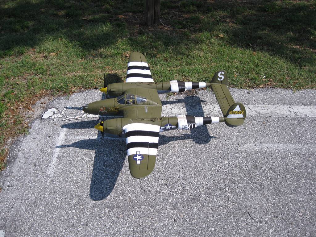

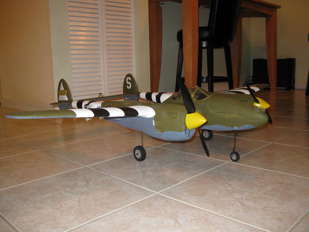

gunny is that a coustom paint job or did they redo the paint?
Old 03-12-2011 | 04:50 PM
Joined: Mar 2011
Posts: 3
From: clearwater, FL
Default RE: E-Flite P-38 build ideas
That is a custom paint based on the "california cutie".I changed the nose to a fighter. Im building another one in pacific theater silver.Ill post pics when its done
