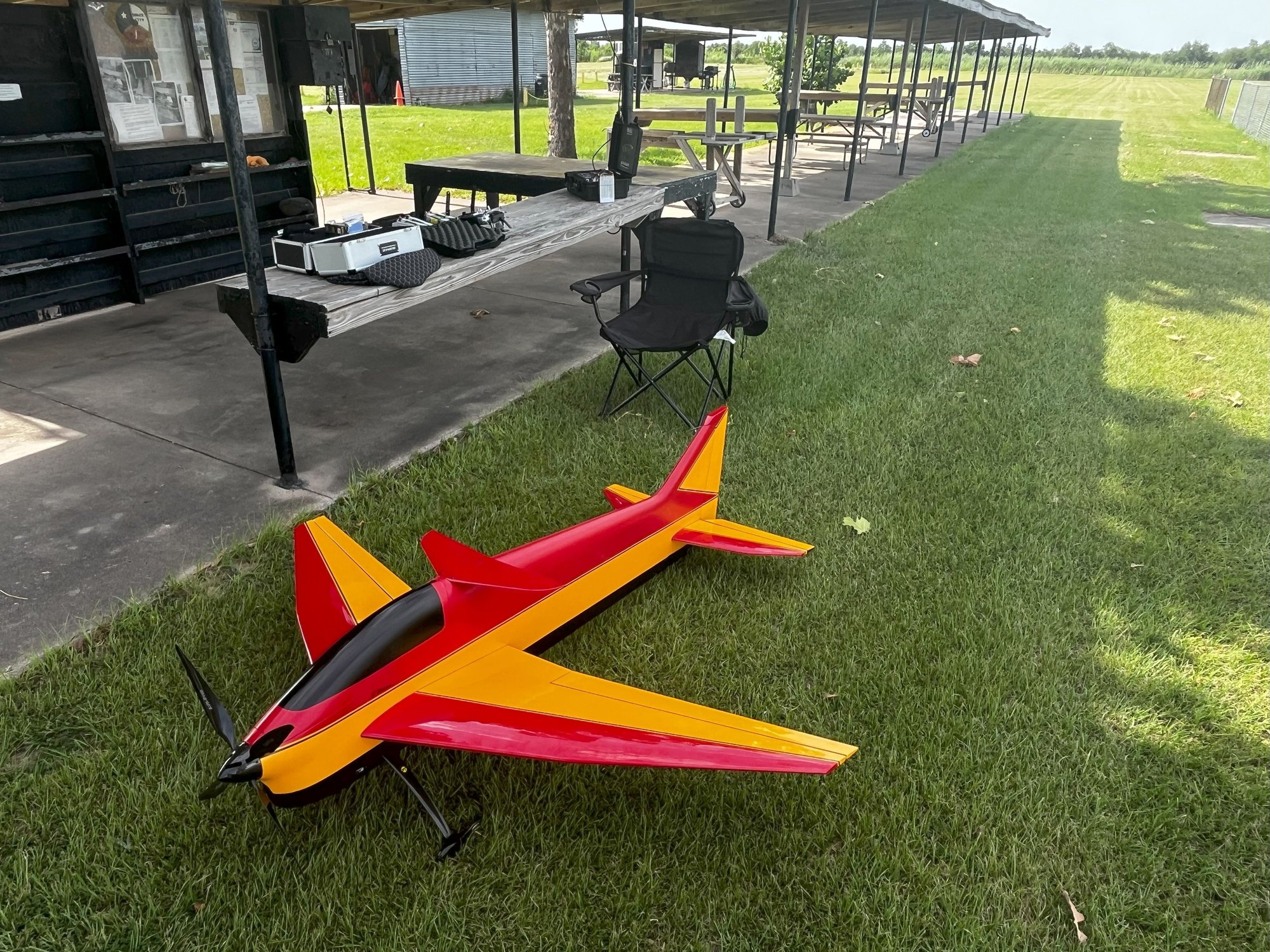

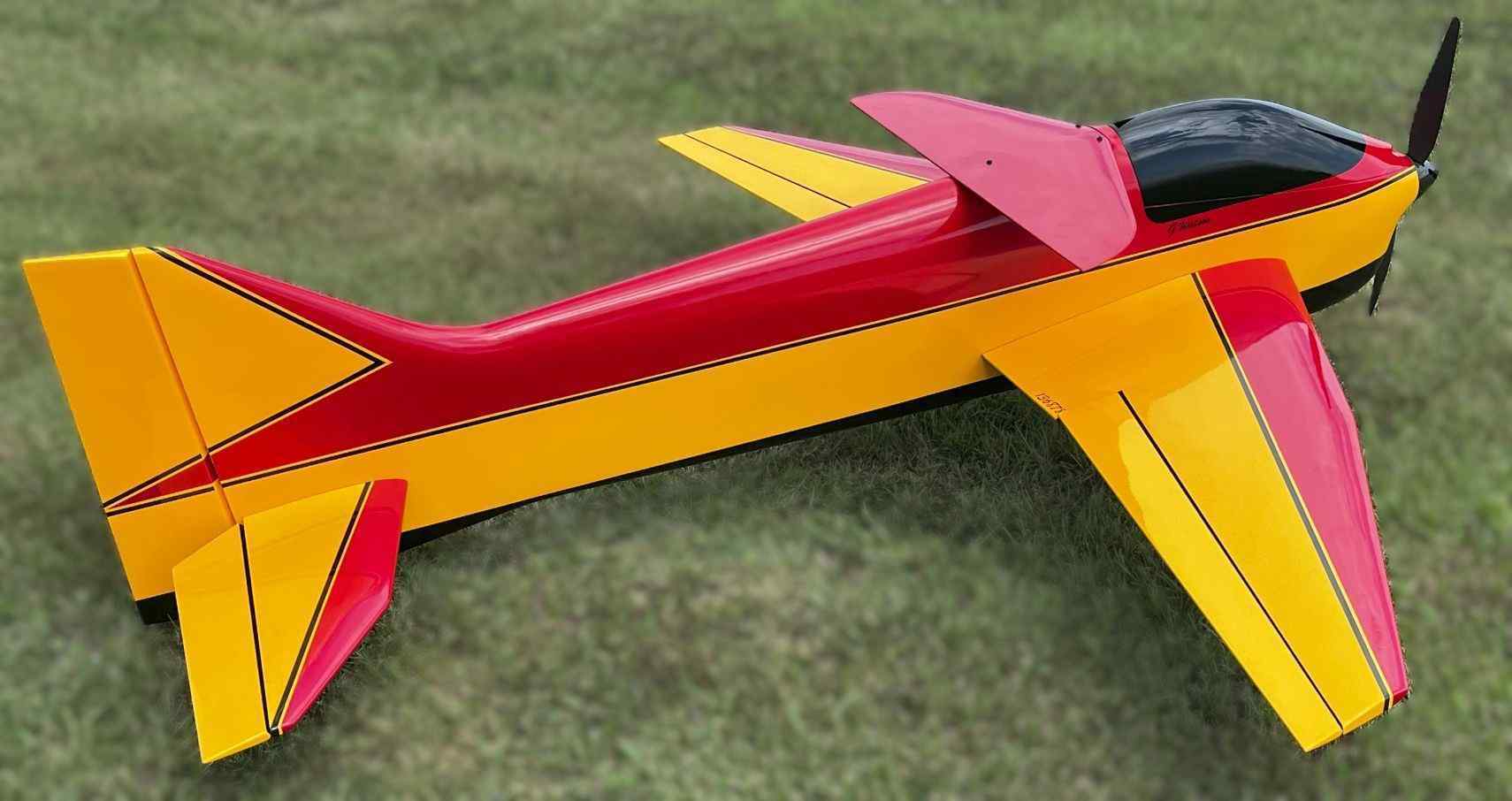

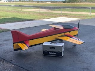

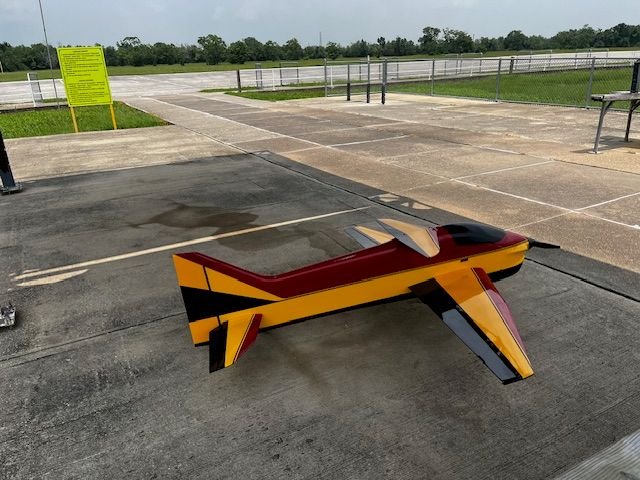

As for color schemes, what works for me is something fundamental. A scheme tailored more towards visible functionality than aesthetics. A 3-color contrasting combination using long lines stretched lengthwise on the fuse, wings, and stabs. Here are a few examples.
BJ Craft Invitation 2019…https://glenwatson.blogspot.com/2019...pleted-bj.html
BJ Craft Epilogue 2021…https://glenwatson.blogspot.com/search?q=epilogue
BJ Craft Anthem 2023…https://glenwatson.blogspot.com/search?q=anthem
BJ Craft Strato 2025…https://glenwatson.blogspot.com/search?q=strato
