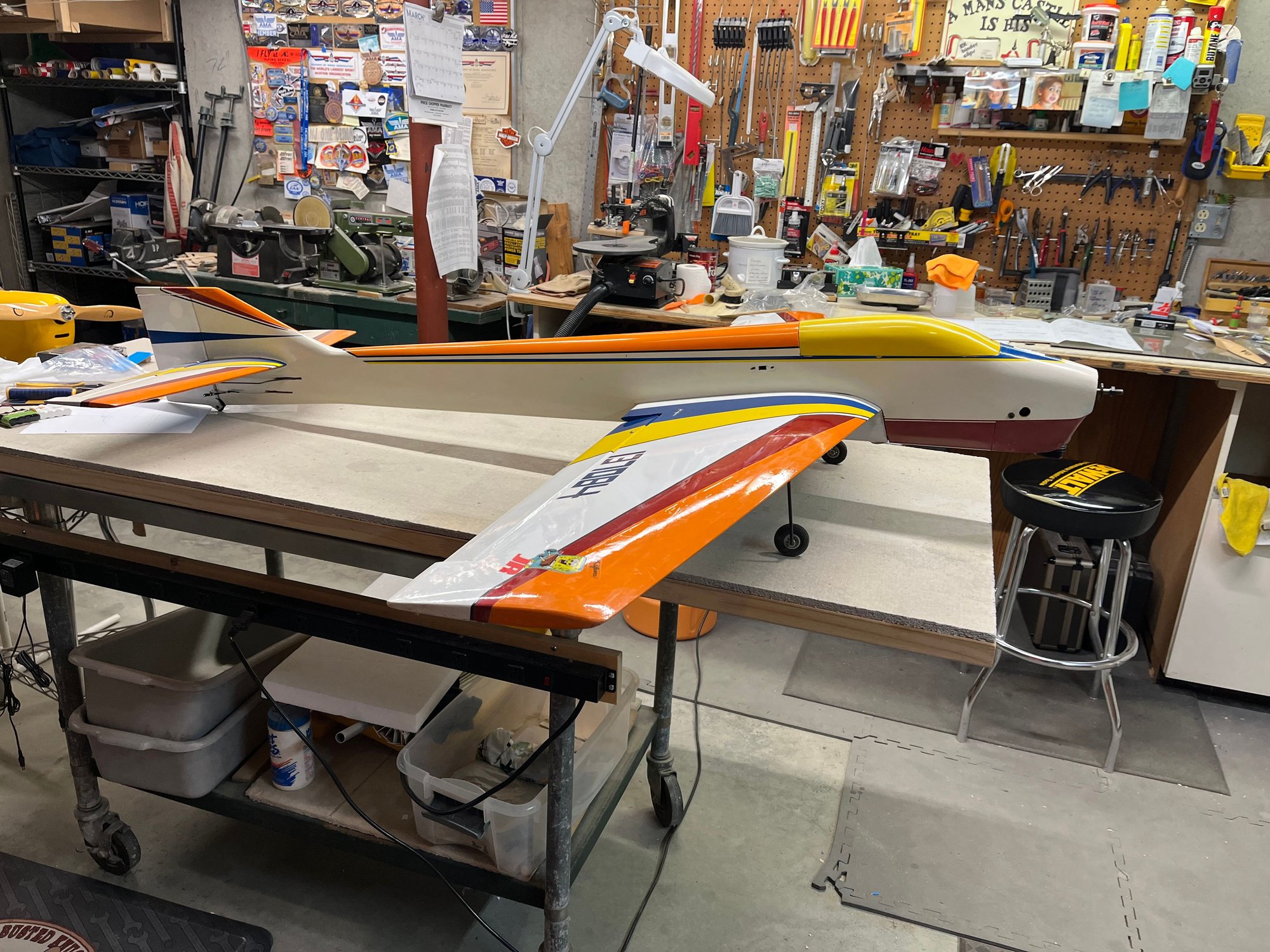

I purchased this old pattern airplane at an auction. I posted pictures of it before and received eight different names for it from eight different people so not sure what it really is. It has a YS 91FS for power minus the needle and muffler.
I went on line and searched for an electric set up that would power the same as the YS 91FS approximately. I have estimated that the finished weight will be approximately 8.7 lbs with battery. Going with the suggested 200 W per pound I am looking at 1800 W. I am planning on a 6S 5000MAH battery. One power system suggested was a Tempest 4130 -540KV motor, Tempest 100A speed control, and an APC 14x8.5 E series prop. This would supply me with 1836W of power.
Another suggestion was a Bad Ass BA4530 -550 KV motor , Bad Ass Renagade V2 125A ESC, and a Bad Ass 15x7 wood electric prop. This would supply me with 2170W of power.
Then I went on line and watched a you tube video of a person showing how to figure out what would be needed. Using the 9 lbs times 200 W per pound for a total of 1800W I came up with 81A. With some overhead I came up with a 6S 100A ESC. It also worked out to needing a 35C battery. This airplane has a 66” wingspan and using his formula it came up with wanting 12,183 RPM and a KV rating of 548.7 which will round up to 550 KV. Following the rest of his formula’s it works out to a 11.24 diameter prop with a 7” pitch. So rounding this off I would end up with a 11x7 prop which seems slightly small.

ecalc.com has a very good prop calculator which lets you try various combinations. You can get a 1 month membership for $6 for prop calc and set up finder. Enter the models parameters and your desired flight performance.It has a very good CG calculator too.
I've used it for years and have found it quite accurate.
