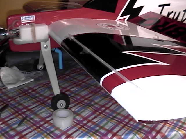

i just got back from the field and my experiment worked!
my new profile design would wallow like a dying fish when i tried to harrier and that upset me because i was having so much fun with it and that was the only thing it would not do well (my spa3d can harrier all day long with no complaints)
so i had a hunch, !QUOT!lets try some turbulator strips!QUOT! i said to myself.
so i took some antenna tube cut 2 pieces 15!QUOT! long and taped them to the wing, outboard (from the tips in). at first it did nothing then i moved them to about 1 inch from the LE and BINGO, now she harriers rock solid!! i was so excited that i did a victory roll that sent one of the strips flying on its own! (no harm done though)
so now i need some permanent strips top and bottom
try them if you are having harrier problems, you will like them.
now i just need that 3D chip
anybody have a similar situation

any chance of some detailed pics,
sounds very interesting

Old 10-12-2003 | 09:43 PM
Spastic's Avatar
Joined: Jul 2003
Posts: 441
From: Buffalo, NY
Default RE: harrier problem fixed
this is the original thing i used, it is the thicker (3/16) size antena tube. the tube goes to the tip, (15"long on a 46" span)
yesterday i tried 1/8" wide 1/16 balsa 18"long but that must be to small because the effect was about inbetween good and nonexistent, next i will try 1/8" sq strips, top and bottom.
There was no effect on normal flight, i could not belive it myself, not even trim change.
its the classic golfball effect the turbulators "trip" the laminar flow making it turbulent, the turbulent airflow is more resistent to seperation than the smoother untripped (without the strips) airflow, so the wing does not stall as easy. at least that's what i think i read. it also can reduce drag
the 2 critical factors are the size of the strip, and the position in regards to the LE, to far back and its to late (the flow already is seperating) and too far forward the strip can act like a sharper LE (not what we want tward the tips)
i also suspect that the size and placement requirements for my airplane will be different for yours.
try it and tell me what you find, the weather just turned for the worse here so i may not be able to fly till the weekend.

Old 02-25-2004 | 09:05 PM
Spastic's Avatar
Joined: Jul 2003
Posts: 441
From: Buffalo, NY
here is the pic again

Old 02-26-2004 | 06:45 PM
Spastic's Avatar
Joined: Jul 2003
Posts: 441
From: Buffalo, NY
Good, somehow i lost the other pics on my site but i got one of them back.
I just flew another plane that had the harrier problem with the turbulators and it did seem to make quite a difference.
i was able to harrier with the wind with lots more controle thatn without the strips.
I need better weather to test this stuff more.
try it yourself, all it takes is some tape and some 2 12" strips of something like nyrod or even 1/4" balsa sticks.
have fun
