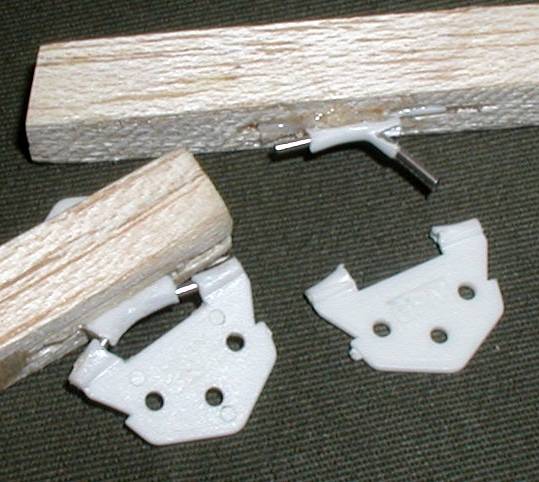

While searching for hinges on Tower's site I saw these. They are designed for CA or epoxy. Ya, right- I thought. Turns out I had two of them in a sample pack of Great Planes hardware. I cut slots in a piece of 3/8" balsa, put some thick CA in the slot and on the hinge, and shoved it in. 10 minutes later I tried to pull it out. Then I attached a vice-grips and tried again. Pulling teeth would have been easier! To my amazement, the pin started to bend and then one half where the pin rides in split. So I tried it again. Same result! I'm going to give them a try on my Laser 3D.

I took some pictures of the hinges after the test. Pinning would not have helped in this case. I used to pin hinges in the seventies, with toothpicks. Used to blow epoxy into the slots with a flattened straw. What a mess.
These hinges are designed for CA or epoxy. They have a rough exterior. I wouldn't have believed it had I not done this test. I used thick CA.
Here's the tech notes from Tower-
FEATURES: The specially textured nylon helps fast setting CA's or epoxy get a strong grip for fast lasting bonds.
It is shaped to insure bond strength at (3) critical points:
1- At the edges 2- On the surfaces 3-Through holes
Customer will not have to wait for epoxy to cure before moving to next step.
Special roughened plastic material designed to be installed w/CA or epoxy.

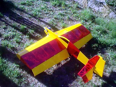

Old 05-11-2002 | 12:41 PM
Posts: 35
From: Perth, Australia
Default Hinges for 3D
HEre's the fun tiger extra arf recovered in monokote =] ready to fly but im out of fuel !! Featuring hinges as above in this thread.. I'll let everyone know if they fail *argh hope not*
