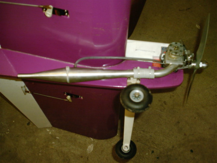

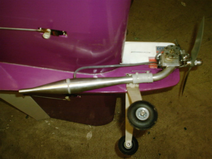

Well got the pipe on.
12.25x3.75 APC 14200 RPM Static
All I can say is WOW!!! A Rocket!!!
I angled it down a bit to help with fuel residue but I may be getting a bit of up thrust on the side the pipe is on..Tried a few hovers today and it was pushing back on that side the pipes on, didn't do that before, it was a bit windy so I will see if it does it next time out, if it does I will put pipe inline straight.
Here's a few PICS

It is the 1140 Tuned pipe, which is the 7.5cc size rated for 40-50 according to the mac site. It is the tuned pipe, not the quiet pipe so may appear to be smaller in length. Forgot to mention that I ended up cutting off 1 7/8" total from stock header #2590.
1" off= 13600
1 1/2" off= 13700
1 3/4" off= 13900
1 7/8" off= 14200
All using APC 12.25 x 3.75 Elevation 70' above Sea Level
14200 is good enough for me but I may have been able to get more. Transition is great plus reliable...didn't want to push it too much to end up with just total top end and tempermental running engine.
