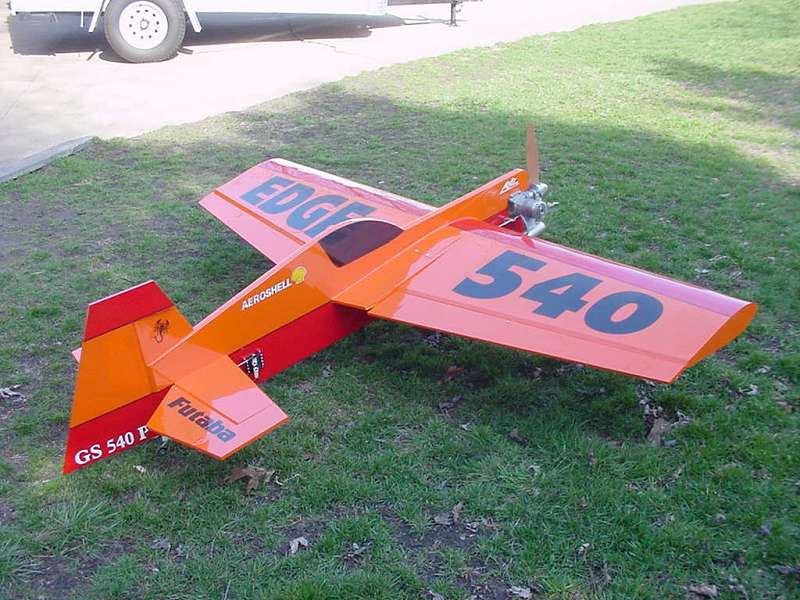

Default RE: Giant OMP Engine?
Im at 610' above sea level. We have 2 of these flying. I have a 210 Moki the other has a Saito 180. I like the Saito better. Throttle transition with the Saito would be hard to beat. The Saito plane is lighter, to offset balance we used One rudder servo vs. 2 with the Moki.. If I were you, use the Saito. It pulls out of a hover effortlessly..Sounds great also...walt

That's surprising to hear. There were one or 2 people in the large OMP thread that were not thrilled with the 180. Maybe it is just the difference in elevation?
What prop are you running on the big Moki?

Zinger 20-8....APC 20-8:
