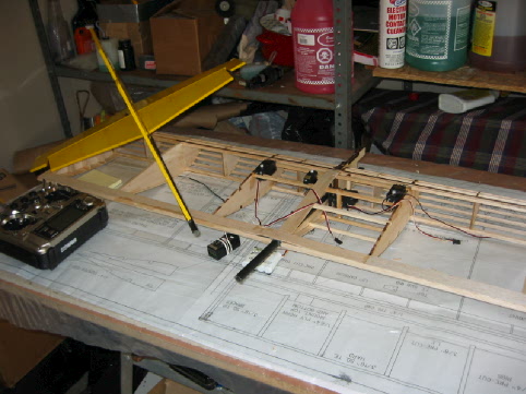

I have one on the board now
my last one took a beating at the last three funfly's
at one the vertical stab tore off on a high speed dive and the plane came spinning down. when it landed i lost two bays on the wing. I repaired it and made it though the next funfly which was the following weekend but that day was a 25mph crosswing so the plane was a little over worked. yesterday was another funfly and the plane made it through the day but after the day I was doing some croud pleasing and POOFFF the wing folded on the repair.
I took Top Gun in the funfly but take a look at what I went home with.
these planes are great. there was a 5mph dead on wind so for the spot landing I would harrier it right down.
there is always someone asking me what plane that is after first fllght of the day.
it's a good feeling.
I"ll post photos on the new one in progress tomorrow.

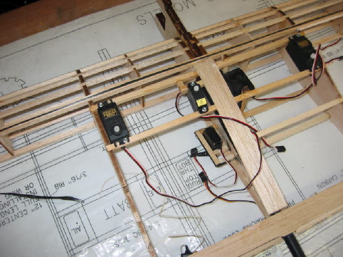

.for ailerons I have 9102's
for elevator I have hitec 645mg
for throttle and rudder I have micro servos.
Do you think the rudder servo should be enough at 30oz of tork.
it's a futaba 3002
it's a futaba 3002

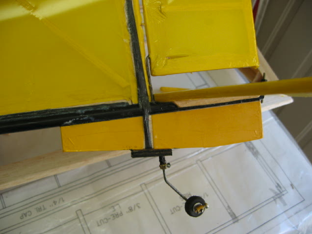

You gonna do pull-pull on this one? I've got a HS 81 MG for rudder control on my Taco.... It's enough...... You might get by with it.....
Posts: 568
From: brooklyn, NY
I will do a pull pull on the elevator again in fact the elevator servo is already set in place. I put a Dubro long arm on it which will give me sick speed and throw.
I would like to mount pull pull the rudder also . that will be the last thing I do so i haven't decided yet.
I spoke with mark shope the other night onthe phone and askedhim what the prupose of the profiles were. I though they were there to reinforce the boom. he told me that this plane was designed for a spacific class and the two wheel and the profile were part of the requirements.
I may leave the bottom profile off. The top profile I will put on. It's like the only place to grap the plane by. Although sometimes I grap the plane by the wing tip and walk it out that way. I even like to launch it that way.

Here are the preliminary numbers.
tail section finished with wing and servos 1lb 6.7oz
engine, exhause, landing gear, radio, battery, 1lb 5.6oz
nuts and bolts 1.1oz
the only thing not in there is the contron rods for the ailerons and what ever system I go with for the rudder. I think I will go with pull pull for that though so minimal weight.
my goal was 3.5lbs or under and It looks like i'm on track.
right now the total is 2lb 13.4oz
with all the xtras i should finish at just over three pounds.

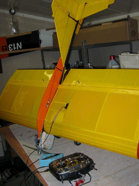

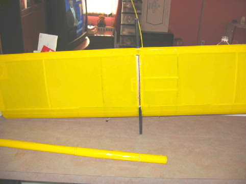

I did use the nelson lite film for the top of the wing. on the bottom I will be changing the color so I will use monocote for that half of the wing. it will stand up to the seashells a little better
Posts: 568
From: brooklyn, NY
I will fly it tomorrow.
it finished at3lb 10oz which is 2oz heavier than the last one but in radio equiptment I have much more.
and with the 6 vlt battery it should really respond.
on ailerons I am using 9102's
for the elevator I used hitec 645
and for throttle and elevator i used micro.
. cant wait.
