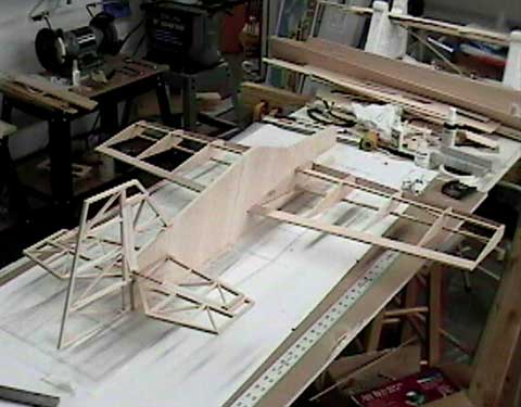

Default Construction questions
Paul,
Just wondering where it likes to be balanced. (I'm guessing on the spar? ) Also, what thickness/width alum. did you use for the gear? It's been a blast to build so far. I started yesterday, already have the tail and the fuse built and the wing framed ready to be sheeted. This is my first profile - do they all build this quick?! I'm pretty pumped b/c I had most of the wood already and pretty much all the hardware/motor/radio/monokote, so it's only gonna cost about $25 out of pocket! I'll post more pics when I get her finished.
Matt
P.S. - Where's the field in Memphis? I'm in Cleveland, MS right now @ DSU, thought about coming up one weekend to fly w/yall.

Are you gonna sheet the wing? Might be a little flimsy with out it...
I have mine balanced about 1/2" behind the spar... Flys pretty good there. I had some .080" thick aluminum from an old sign I used for gear... I've got some .050 titanium now.... Great to know guys in the aircraft industry!! You could probably use some 1/8" x 3/4" aluminum bar stock from Home Depot. Might need to drill some lightening holes....
I attached my gear with two bolts, on that went thru the top motor mount and the other thru the bottom motor mount.
