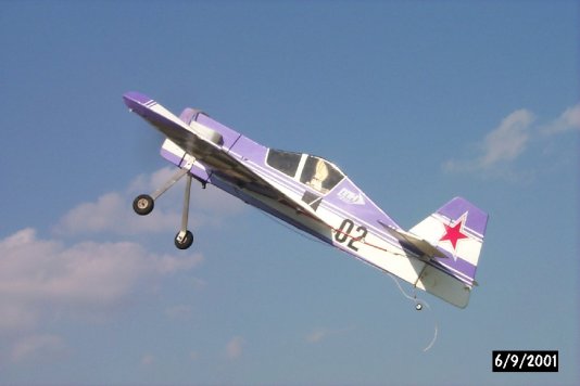

so then this would be HIGH ALPHA? that is if its right at stall speed?.....Gator

termigator has a good point, that pic may or may not show high alpha.
Angle of attack (alpha) is determined by the angle of the model to the "relative wind", not the orientation to level flight. Using an Elevator maneuver as an example. The model is in a level attude but descending nearly vertically. Therefore the angle the wing "sees" is actually very high, even though it appears externally that it's flying at a low angle.
Also, keep in mind that a wing can stall at ANY speed. The determining factor is the angle of attack.

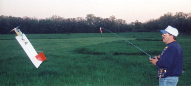

Here's my OS 25 powered PBF in High Alpha forward flight.

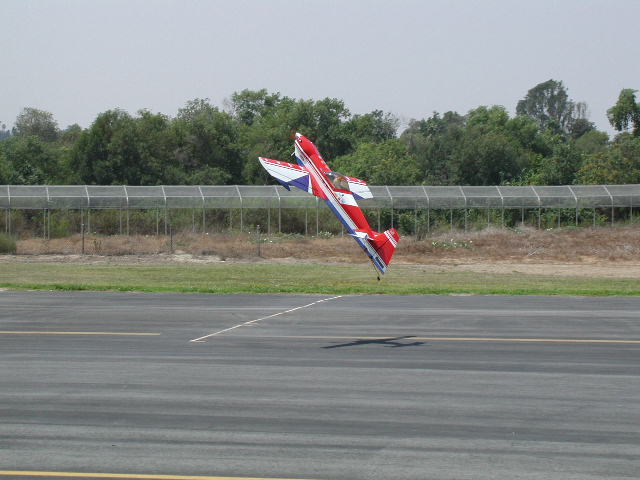

Just out flying with a buddy of mine yesterday ha ha.

Dave, seeing your picture reminded me to ask you how does your PBF handle in reverse alpha flight? My Stamp has quite different characteristics with nose high reverse flight than it has for forward. James
