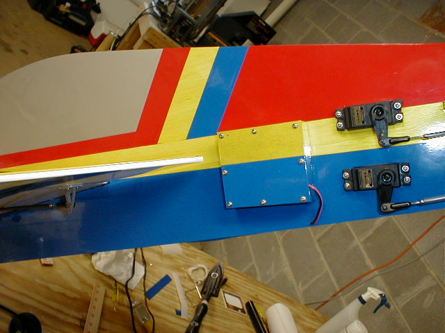

Try moving the battery to the trailing edge of the wing. If that is not enough to get the CG where you want it, the battery can be mounted on the fuse, or change to a larger/heavier tail wheel.
I put my battery on the fuse.
Eric

Thanks for the help all.
Eric,
thats where mine ended up at also. Does not look as preaty as yours. Just straped it there with tie straps.
If the plane survives long enough then I will make it look better.
