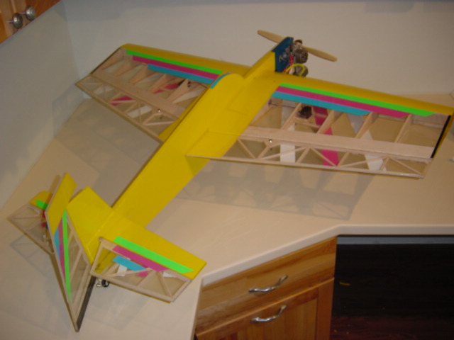

Here's mine ready for flight.
I'm balancing 4" from the leading edge. Seems a little back for my tastes.
I'm running a 46fx as far forward as possible - heavier engines should be a snap with this weight distro.
Flight report later this PM hopefully.

Old 08-31-2002 | 04:28 PM
Posts: 6,378
From: Bloomington, IL
Default Sledge 540 Report
Wow. That looks great.
Let us know how you like it.

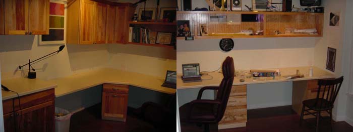

Old 08-31-2002 | 06:48 PM
Posts: 568
From: brooklyn, NY
Default the plane
I like the plane.
but what i really like is the photo.
plane on the kitchen counter and the photographer on the high chair.
we'll eat later.
a true hobbiest.

Flight report - a short shake down flight. Have one of the better flyers fly her:
- little or no trim adjuestments needed
- *extreemly* stable
- CG ok - just a bit of down elev to keep level in inverted flight.
Will really try her out tomorrow - wanted to keep it rather docile to make sure there weren't any stress areas that needed beefing up.
Flew with FX46 and Zinger 12x4 prop.
Came in at 4lbs 3oz - really wanted her under 4 lbs - I'll have to see where I can snag 3 oz.
Happy I built her rather than go the ARF route.

bugsiegel - that is actually my work room - I know it really looks like a kitchen! I went a little crazy during renovation because I always had gone the hollow core door over file cabinets. I do have to tell you that Corain is one of the best sufaces to work on. Perfectly flat and everything come off either by scraping with a single edge blade or windex.
