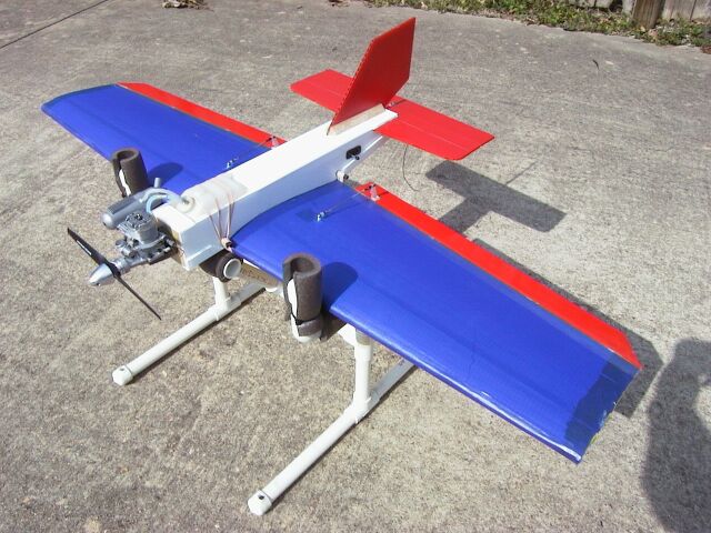

Guys, thanks for the follow ups.
I have a couple of ideas to try when I go out testing tomorrow.
The plane I am setting up is a scratch built open-B combat plane me and some buddies in Dallas have been refining. Here is a picture. Engine is a OS 25FX on a mousse can and a 9x4 MA. I am turning about 18K RPM on the ground with this rig. All-up weight is 2lb 12oz - Super fun airplane to fly.
Almost all the planes flown in this class are short coupled, long wingspan airplanes. A wide flight envelope and high maneuverability are essential for good scores (Just like the big ones) Sharp high-G turning maneuvers, especially at high speeds, are a big edge on the competition.
I also have a Su-Do-Khoi and a Fun-51 I bash around as sport airplanes. I have been playing with flap mixing on all of these.

I beleive the short-coupled setup will inhibit the usefullness of flap mixing to the extent we do it on Unlimited Fun FLy ships. The elevator needs a lever arm to fight the flaps successfully. With a short-coupled rig, I think the mixed setup will act more like full-crow airbrakes. However, experiment with various amounts and see what makes the tightest loops.

Interesting. It was a rationalization, but possibly wrong.
Both planes we are talking about (Unlimted boom plane and Knife) have large airlerons comapered to the combat plane pictured. I wonder if that could be causing his troubles.
I do know that the "best" moment on the boom planes seems to be around 19.5-20", but "best" is relative to the job at hand. We need to balance stability with manueverability. For some events (fun fly vs unlimited) the current trend is to slightly longer moment to bring back some stability.
I also notice that the ailerons shown above do not extend into the thrust line like our two planes. This may affect the effectiveness as well.
Bottom line, try until it improves, and don't be afraid to get radical. You can always turn the mix off if it does weird things.
