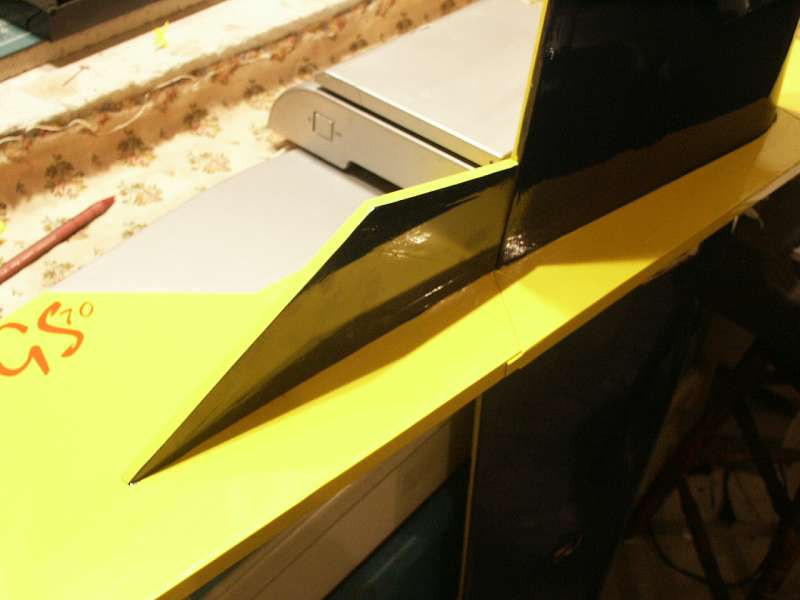

How bout a few pics and stories for the curious.

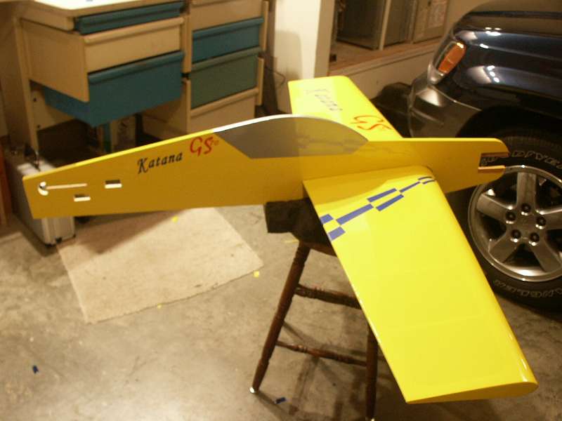

Arrived in very good condition. I weighed every pc of the plane and the airframe came in at 40 ounces. The gear with screws less wheels weighs 4 oz. I allways start by taking a soldering iron and opening up all hatches, servo openings etc as shown by my first pic.
The first thing to do is glue the wing to the cartridge (for lack of a better term). Slip the cartridge over the wing and into the fuselage. Square it up using the normal cross check methods and mark it. Remove the covering on the wing where it will sit and glue it on with epoxy. Set it back in the wing, check for square and let dry.

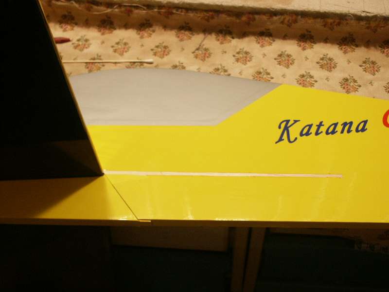

When that was good and dry I removed the covering from the edge of the wing fairing and lined it up on the wing keeping the same distance from the bottom. Marked and removed the covering from the area on the fuselage where it will sit. I did that on both sides first and then glued one side at a time with medium ca checking for square to the fuselage and proper measurement (gotta do it quick)
Shown in the next two pics.
Thats all for tonight

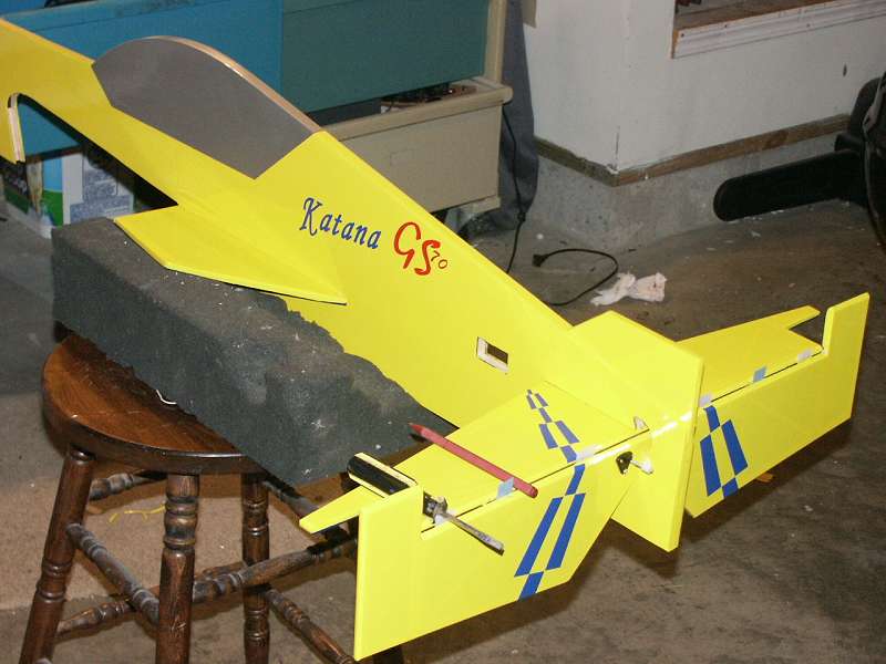

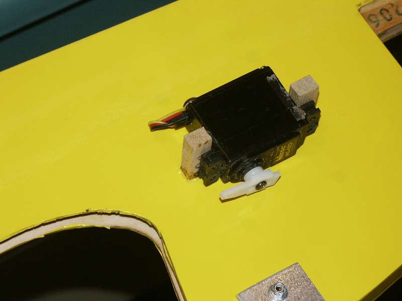

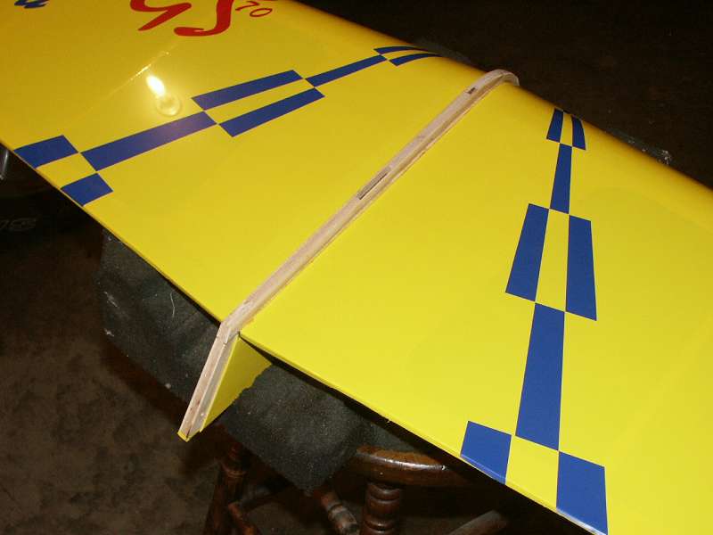

Ive got a bunch of hitec 625's and 645's in the drawer and Im going to use a few of them up. I have also purchased 2 of the bluebird 621 MG servos to try. 100 oz at 6v with .10 speed for just under 22 bucks. I figured Ive got to at least try them for that kind of money. I allways put the control horns on before I glue the surfaces on so I also got the control horn on the elevator and the rudder last night. As it comes there are only 2 hinges on each elevator half and 2 hinges on the rudder. It would make me feel better knowing there were 3 hinges each so I used my GP slot cutter and added a third hinge to each elevator halve and the rudder.

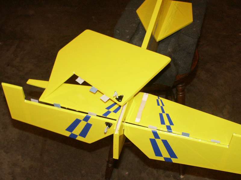

The first pic shows the added hinges and cut aways and the second pic is the stab while the epoxy is drying.

I was OK with the elevator having 4 hinges, but the rudder got a third from me as well.
Wing and fairings done.
Tail done.
Engine mounted.
It's time to find some servos...

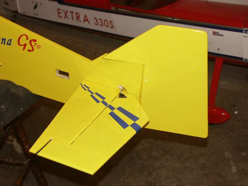

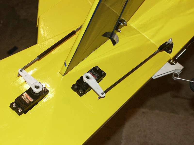

Of course the next step was gluing in the tail surfaces using thin ca. 1st pic is the completed tail. I then moved to the wing. The BB 621mg are 100 oz servos so there a smidge bigger than standards. Some trimming and filing were required to get them to fit the bay. I also had to put a 3/32 shim under the trailing edge to slightly lift the servo to keep it from bulging the covering. It didnt buldge much at all but I figure while Im there... The second pic shows the servo installed after attaching 12" extensions and fishing it through the wing with string. ANd finally for tonight the 3rd pic shows a close up of the control horns, they look pretty nice to me. 3 2-56 bolts pass thru them and a back plate on the opposite side is held with washers and nuts witch I loctite on. Tomorrow I'll glue the ailerons, install the gear and start the tail servo install and saturday I should get pretty close to done.. Later

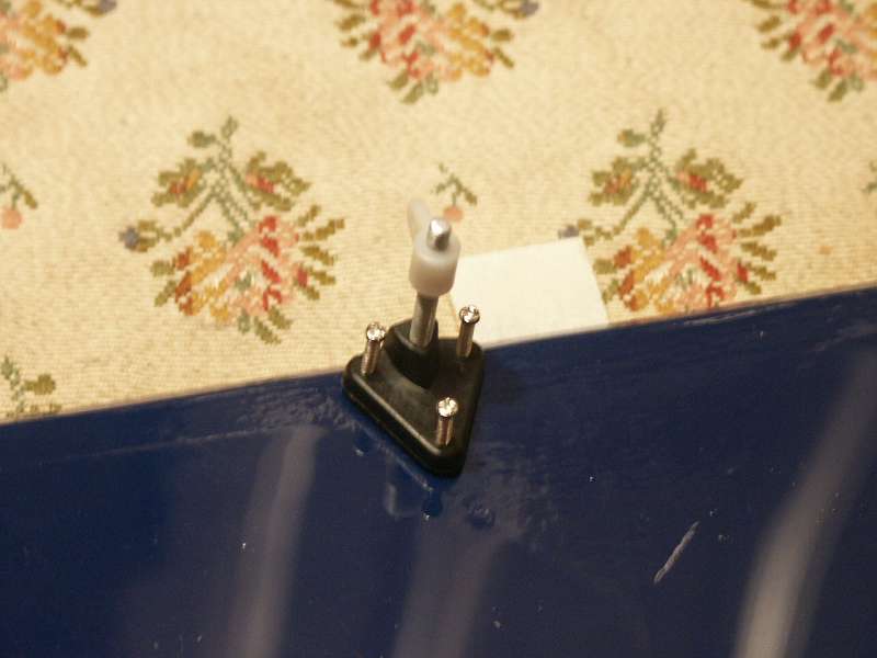

I was impressed with the control horns. The 3D guy that automatically tosses the hardware pack in the trash will regret it on this one.

As far as needing stab support. I really dont think that will be necessary, when slotting thru the trailing edge of the stab and the leading edge of the elevator I ran into some pretty darn hard wood. Im guessing they used some form of hardwood for those for strength. I also put the bolts and wheels on the gear last night. Pretty typical FF stuff, a hard bolt thru the gear fastened with a loctited nut, then slip a washer on each side of the wheel and bring a nylon locknut up close to keep the wheel on. The tailwheel setup is kinda cheesy so I dug thru the drawers and found a used 40-60 size sullivan tailwheel and I will use that.

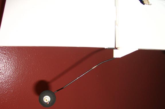

Here is the supplied tail wheel set up. It comes partially finished. I bent the first bend above the plastic mounting bracket, and then the last 90 degree bend to go up into the rudder. It's a pretty inexpensive set up, but I think it will work. If it gets to be a pain, I'll swap out to a Sullivan.

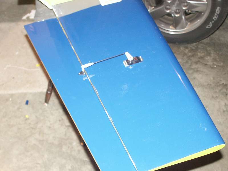

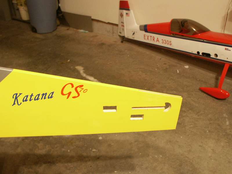

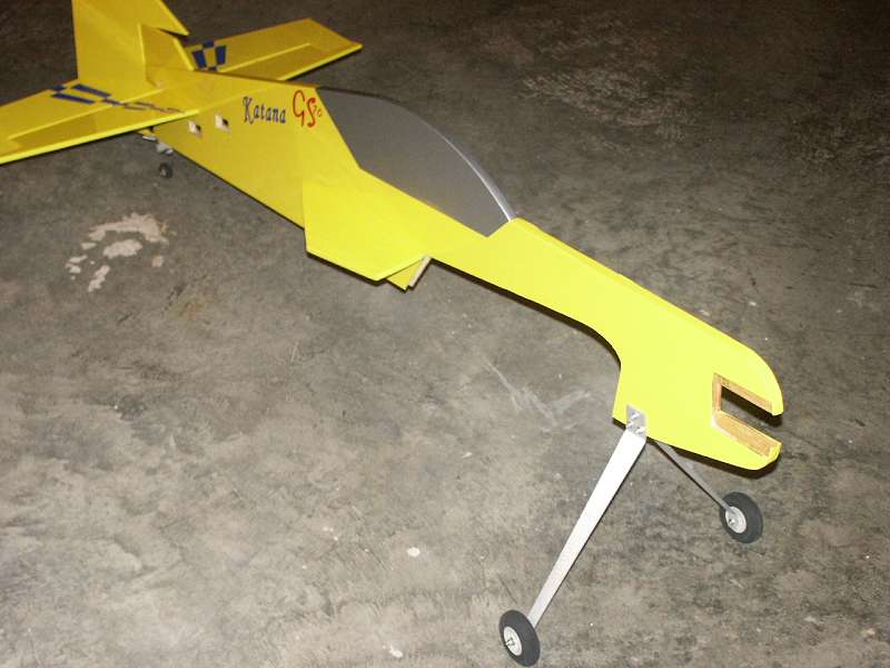

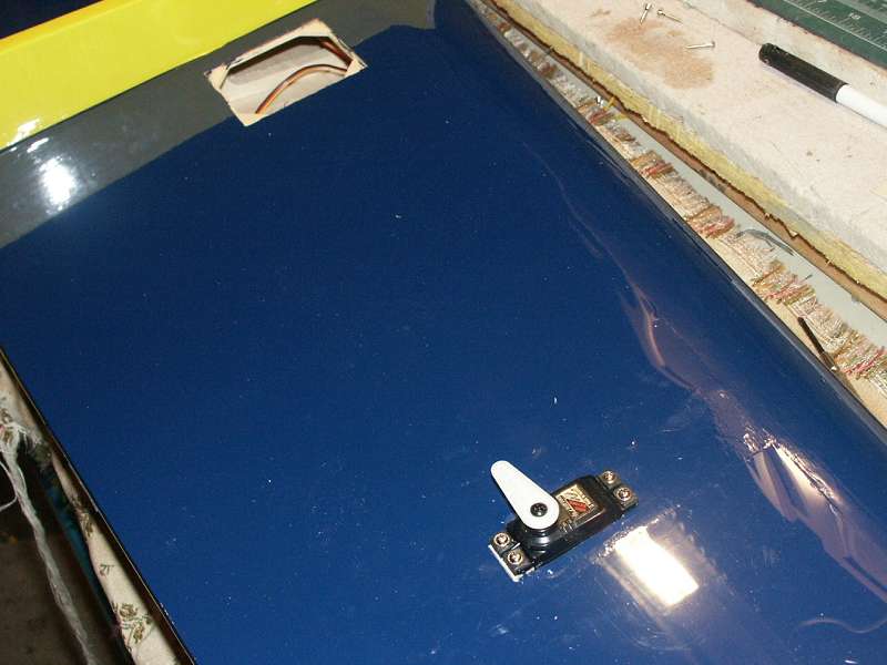

TGIF. I started today by Installing the gear and the tail wheel, easy doins with the provided screws and bolts. (pic1) I then secured the ailerons to the wing using thin CA. While I had the wing up I went ahead and installed the pre bent (and correct length) pushrods using the supplied clevis's. Im not a fan of plastic pin clevis's but These appeared to be of sufficent quality that I went ahead and used what came with it, see pic2. I moved on to installing the servos which slipped in nicely and attached 24" extensions. I fastened the servos and fished the wires thru the fuselage and that went easily. I then went ahead and finished the linkages. Since Im using 100oz servos and the control surfaces are pretty big I went ahead and used 4-40 rods fashioning Z bends and using hayes plastic clevis's with the metal pins. see pic 3. Finally I epoxied in the supplied throttle support beams and mounted the throttle after the epoxy had dried. I fished the wire down the tunnel (see pic 4)
Tomorrow Rx and Motor installation

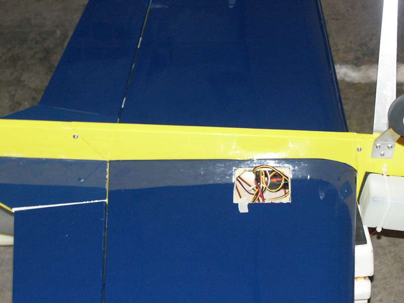

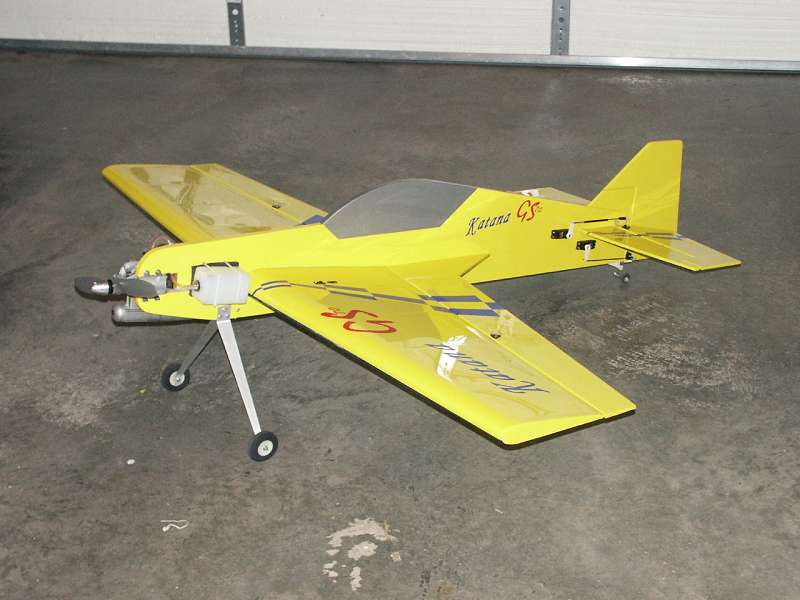

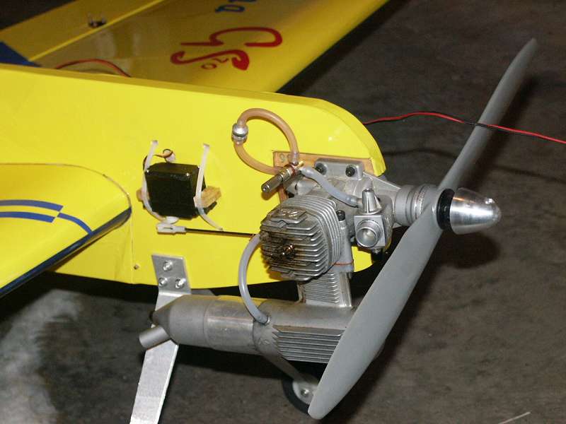

Today I finished her up. I started with drilling a small hole in the end rib and pulling the Rx antenna thru the wing and out the hole, only about 6" hangs out past the wing. I was ready to mount the motor and I knew I needed to put the bird together to determine motor placement for CG. Putting the wing into the fuse while hooking everything up using extensions coming out the top of the wing proved virtually impossible for me so the 3 leads seem to need to be threaded into the top of the wing and straight into the Rx (or 3" ext coming from Rx) every time. Im not sure I will like this combersome step every time I put It together but time will tell. Anyway the wing went on nicely after all the leads were pulled thru and hooked up to the Rx. I clamped on the motor and could tell right away I was going to need all the nose weight I could get. I roughly determined the placement and installed the motor about as far forward in the mount as possible. I then installed the muffler propellor and spinner. I had an APC 15-4W that I had run on the 91 so I will start with that. I installed a 6 volt 1650 NIMH pack as far up in the leading edge of the wing as I could get and installed the power switch and charge port. The correct starting CG is 6" and I balanced out at about 6.25 inches, well within the range of reason. But a lighter engine is going to make this bird pretty hard to balance IMO. With everything complete I programmed the radio up, set the centers on all the servos gave everything a quick test. So far Im not real impressed with the bluebird servos. They are supposed to be .10 speed but seem pretty slow and they dont allways center perfectly but some of that may be the stiffness of the new hinges. I still need to program rates and expo but she is complete. 6 pounds 1 ounce all up (dry)ready to fly. An OS 91fx should be balistic at 6 lbs
Pics to follow
