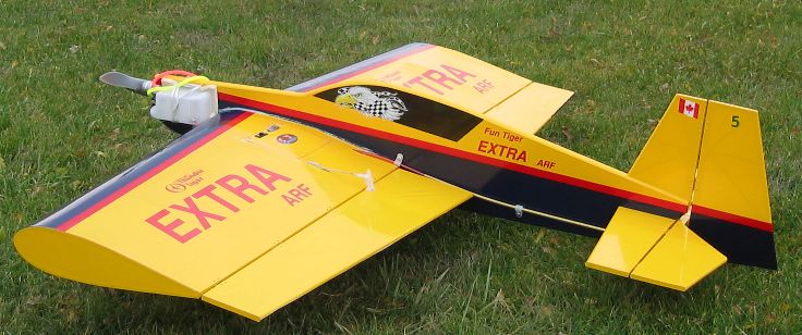

A friend was flying this plane with a piped Rossi 40 (heavy and underpowered) when a case of high speed elevator flutter exploded the tail feathers and "boom boom, out go the lights". Since the price was right I brought it home for some lousy weather entertainment. It now has a new tail (Morris Knife clone) and I put the tail servos in the rear of the fuselage to eliminate those worthless plastic tubes. Man, that covering they used is a mess.
Does anybody know where the CG should be? The front of the wing is slightly tapered back so I'm not sure where to measure back from.
With the added rear weight from moving the servos back, I'm guessing that it's gonna be pretty tail heavy (even tho it was a little nose heavy before) so maybe that 60 OS in the nose will help counterbalance the servos and have plenty of power to pull this overweight rascal.
Any help would be greatly appreciated.

I fly this plane all winter....it's my beat around winter flyer. You are right, the covering sucks big time...it's sticky backed. After a few cleaning off of oil and muck...the sticky substance comes out the seams and looks like "nose snot"...Eeyucck. I routed my control nyrods through copper tubes to the back for rudder and elevator. I was inverted last summer, zooming by the field when the rudder control snapped and caused a lot of flutter. I cut throttle rolled her over and brought her in for a landing. I was lucky.
Ok....there is an Addendum included with the manual...it says for CG balance your Fun Tiger at the rear edge of the leading edge wing sheeting.
The effective CG range is 4- 3/4" to 5- 3/4" back from the leading edge of the wing where the wing meets the fuselage.
Hope this helps. Here's a pic....notice the brass tubes for nyrods.

I'm using the new ASP .52 2-stroke on this plane. It's more than enough power for hovering and pulling out. I'm using a MA Scimitar 11X7 prop. The plane is too fast with that setup...flies half throttle and hardly uses any fuel. The engine is developing more power, so I may have to take it off and install an OS .46. I set my CG at 5" back. At this location it balances perfect for my kinda flying.....
Keep us upto date with the servos in the tail performance.
