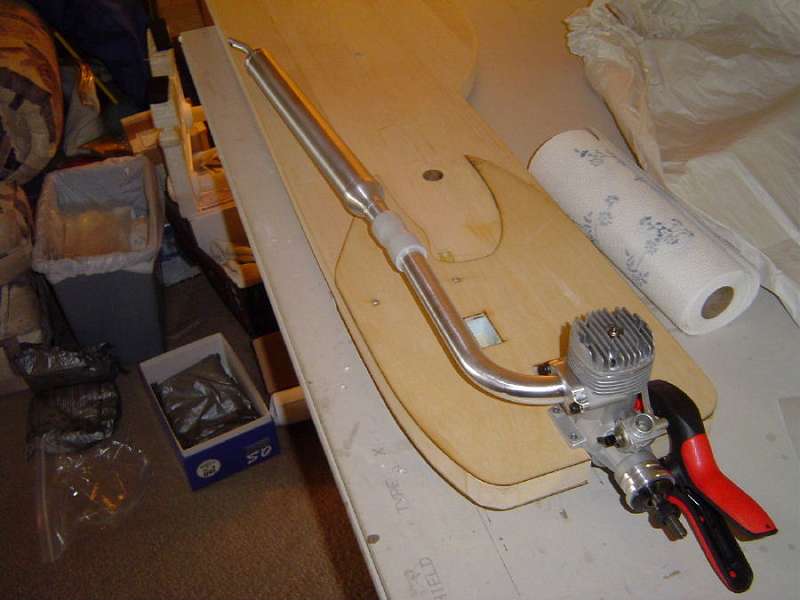

Hey mike where is the best place to mount the pressure fitting on the tuned pipe that OMP sells. this one in the picture.

Dennis, I think I answered your email to the OMP site but for everyone: The best place to mount the pressure tap is right smack on the aluminum header flange next to the engine exhaust. You get good constant pressure and you also have plenty of meat to tap into.

Thanks Mike
