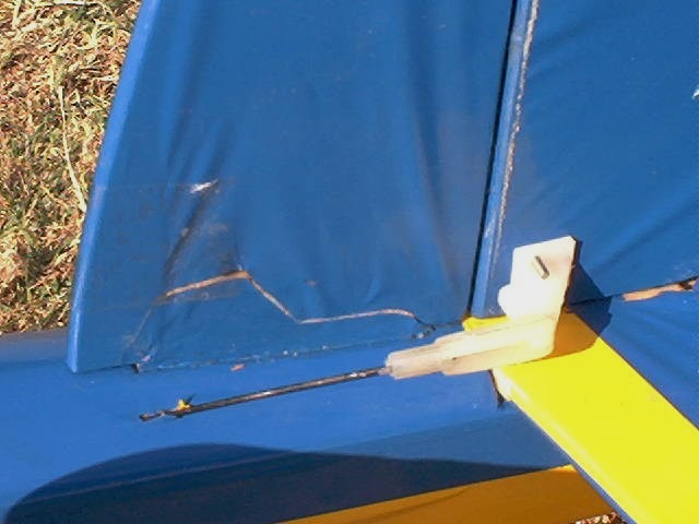

11!!! on a 32,, ooooh nooo you need a 10 x 4 for instant responance.
Standard servos are fine.
Magics suffer from weak rudder fins, beef yours up.
there are two in our club and they both broke, and those flyeres dont even throw them about

Anyway, back to the magic. Thanks for the tip on the rudder/fin. I will make up some wires or triangle stock to reinforce it. How well did you like the pull/pull linkages? I am thinking of changing those out for 20 lb test spiderwire braided kevlar fishing line(rated at about 45-55 lb test monofilament). Should shave off a small amount of weight there.

pull/pull is great for rudder, gives huge movements, but i use push rod for elevator, just to get the stiffness there, just keep those lines nice and slack free & PLEASE! dont use plastic clevises

Ok, pull/pull ok for elevator 2, rods are just my fave, but you gotta swap those links, you may live today, maybe tomorrow... but one day, this will happen........

That is not the first complaint ive heard about the magic's weak rudder. I am still wavering on selling mine to wingspan99, or slicing the hinges and building a larger rudder. I would assume it would need wires or some other methods of strengthening. How much larger do you think the rudder needs to be? I am thinking mine should be around 3 3/4 max, which should equate to a blast with the os32 and the macs pipe. It takes my 3 3/4 lb extra and accelerates it obscenely while vertical. What is the thinking behind the 46 and up sized motors on this airframe? Is it just "because it was there", or am i just powering mine too low? I thought the intent of this plane was to be low, slow, and vertical. I would think that with that massive amount of wing area, you could take it up high, shut it off, and fly it like a sailplane. I may keep the 32 in my extra, and find a used cheap supertigre 45 for it, if it seems like it needs more power. Shoot, I think this thing would fly nicely with an la 46 swinging an 11/5, 11/6, or maybe even an 11/7 APC.

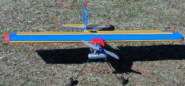

I have been flying mine for a couple weeks now, with an TT 36 heli motor, tail wires, and standards for receiver and servos. mine weighs in at 3lbs 13 oz, no lead anywhere. I moved my battery pack to under the radio tray, and used a miniservo for the throttle, next to the tank.
Why would you want to run a 12 oz tank? That is twice the size of the original tank. I installed a 4 oz right from the get go, and get 15 min flights routinely. Would prob go 20-23 mins if i were just puttin around doing touch n gos. A ys 63 is overkill for that plane. If you end up around 4 1/2 lbs on this plane and it is going to lose alot of its floating abilities. Also, there is not enough room to mount a 12 oz tank in the plane, and still have it balance without alot of ballast in the back.

I did a single 1/4-20 nylon bolt for the wing. I epoxied in a piece of light ply under the rear wing area. I also sank one of the dowels they give for the rubber bands in the front of the wing, as I joined it, and cut a slot in the front former. I also reinforced the top of the former with a small piece of light ply. I started out drilling and tapping for 2, and screwed up the wing alignment, and opted for a single instead. Two will do alot more damage when ya dork the plane (all of these are on borrowed time ya know
). One should snap off with less damage. Thats why you can see a total of three holes in the top part of the wing. I didnt have a monokote iron handy and was anxious to get it in the air, so I havent covered over them.

Heres a shot of the nose, to show the motor mounting. I believe that is a hayes circular mount that I had on my extra. It had my os 32 on it, and the engine tab holes were the same. I have the motor turned almost 90 degrees, to let the heli pipe point downward.
