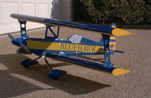

Thought I would share my latest project with you guys. This is my first fun fly attempt and I can't wait to get this little bad boy in the air. Powered with an OS 46FX. Any suggestions on flying would be appreciated.

Looks really good.
I saw one fly with that engine and it looked like it was only limited by the thumbs on the box.
Let us know your impressions when you fly it.

its an awsome plane!!! my favorite of all time! if you get it set up right you will love it,if its wrong you will hate it . dont give up on the plane if the first few flights are not that great. also try not to have to many deadstic landings! they fly as good as a brick without an engine!!
have fun !!!!!!!!!

Had one of these, great little plane, just didn't like to go fast and needed quite a bit of coupling on knife edge. Powered with a TT Pro .46 would hover easy and pull out strong. Good luck, hope you enjoy yours as much as I did mine.

Well, I flew it for the first time yesterday and all I can say is WOW! What have I been missing. Truly a blast to fly. I'm afraid I am now hooked into the world of fun-flying.

I noticed on the 2 pictures in this thread that both of you guys left the holes in the interplane struts open. Is there a reason for this? The full size doesn't have holes in them, nor do any other models I've seen, including the pictures on the box. This would certainly affect knife-edge flight, and I can't see any advantage to it, can you explain your reasoning for all this extra work? I mean, the wings have openings in them too, but you covered straight over on them!
I have never owned that plane. But, I am just guessing. But the wholes in the struts are to get rid of some weight. in a fun-fly as we all know. 1/2 oz here and 1/2 oz there, all adds up to weight we don't need. In funflying the lighter the better, less wing loading, better power to weight radio.

I'm well aware of why the holes are there, I'm just wondering why the 2 in the pictures in this thread have them open. I am just completing my second one of these, and both have the struts completely covered. On my larger Dave Patrick Ultimate, they are also covered over. I see no reason to leave the holes open, and with the added hassle of covering them that way, and the covering for the edges of the holes, there's no way it's going to be lighter. I'm just looking for a reason why the two of them decided to do it this way.

I have mine covered and waiting for a Rx to come in.
I noticed both pics have the tank mounted on the same side as the engine. Are they 4oz tanks? I need to decide whether to buy a 4oz or 6oz tank. I'd like to keep it on the same side as the engine so the other side will look clean. Based on my Fazer, a 4oz tank won't last long. I'll go with whatever fits and take whatever flight duration I can get.
The other guys think it's neat when I do a low slow flyby to check the fuel level. They don't know what they are missing with fun fly's.
BTW, both planes look nice.

I think you're gonna want at least a 6 oz tank, probably an 8. I have a TT 46 on my fazer and it has a 6 oz tank... I am forever running it out of fuel. I get about a 8 minute flight... not really enough in my opinion. I like to have about 12 minutes available and land in 10....

You guys are obviously using too much throttle if you're going through fuel that fast. One fellow here has a 4 ounce tank on his Top Cap, with a YS 53, and I've timed him at over 12 minutes! With my Laser 3D, I have an 8 ounce tank in it. I start my timer when I take off, it goes off at ten minutes, then I land, and I rarely use half a tank. Usually have about 2/3 of a tank left. If you're flying around that fast, you're not getting the most out of your fun fly plane. These things are supposed to fly SLOOOOOWW! Quarter throttle is about as fast as I go in level flight, and only use full throttle to start a vertical climb quickly. The amount of fuel you use relates directly to your left stick. The more forward it is, the more fuel you'll be using! I'm going to put a 6 ounce on my Ultimate FF, and it will be on the LEFT side to help counterbalance the engine! I'll start with my timer at 10 minutes, and go from there.

As for fuel tanks, I'm debating between 4oz and 6oz. Nothing greater. I have my Fazer's 4oz tank on the same side as the engine and don't have any problems with it. As the tank empties, weight decreases, the cg moves toward the rear, and the lateral balance becomes more even...this is the best time for aerobatics!
Putting the fuel tank opposite will help balance when the tank is full, but as it empties, the advantage decreases. I had rather my plane be balanced with an empty tank on that deadstick landing! It wouldn't be a big deal either way. The Fazer and its fun fly cousins have to be the easiest planes to land in the world...balanced or not!
If it's balanced with a full tank on the opposite side, it will be out of balance toward the engine side as it empties. Putting the tank on the same side will cause imbalance iniatially, but it becomes more balanced as the tank empties.
But you know all that...It's really a matter of prefrence of when you want the plane to balance...at the beginning of the flight with a full tank or end of the flight when the tank gets low.

If you are using a 6oz and have room to mount on the same side, that's good enough for me! I'll pick one up first chance I get.
