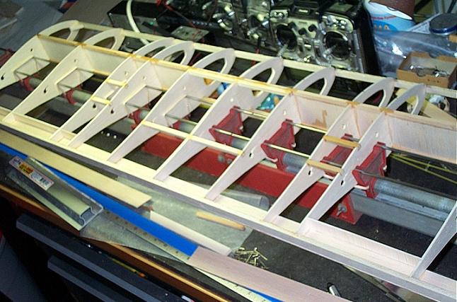

My first FF Hots I built to plans. Had the fuse fracture just behind the wing. The stabilizer broke at the point where it mounts to the fuse. Structure is too light for my aggressive use.
My mods:
raising the height of the fuse behind the wing continuing to the fin. Greater side area for easier knife edge flight.
changing the airfoil to an enlarged version of the Tadpole's foil. (2 3/4 inches thick, same chord)
increasing the wingspan 4 inches.
redesigning the wing construction more inline with the design on Jerry's Big Boy from Morris Hobbies.
same stab area but moving the hinge line forward 1 1/2 inches and adding aerodynamic balances. Moving the stab up 1/2 inch and forward 2 3/4 inches to get the stab in cleaner air.
adding 1 inch to the trailing edge of the rudder along with an aerodynamic balance.
power will be a MVVS 49 w/ mousee can muffler. prop is a cut down 12 1/4 x 3 3/4
I'll post some pics as the construction progresses. Getting ready to mount the ribs on the A-Just-O jig.
I'll answer any questions if you need.
Tom...

Default wing pics
Randy,
Here's a pic of the wing. The sheer webbing is in place between the spars, I am fitting the sheer webbing to the trailing edge sheeting. Note the double reflex airfoil.

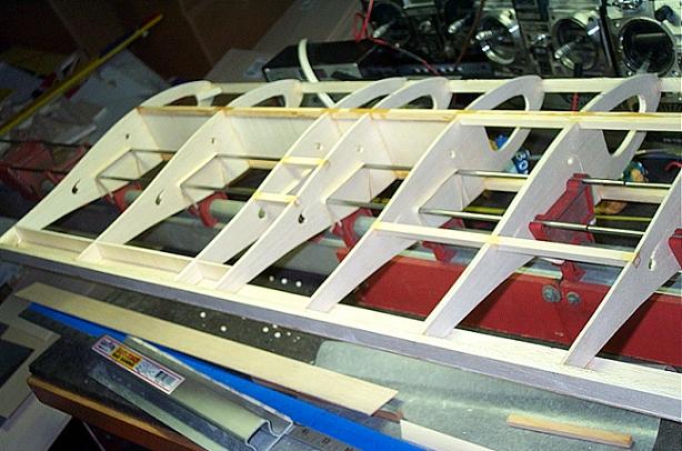

And another view:

Hi tknobby, what type of wing jig are you using ? Thx..........
Old 11-18-2002 | 01:55 PM
Joined: May 2002
Posts: 189
From: San Antonio, TX
Default Jig
rajul:
An A-Just-O jig I bought off eBay. They're not made anymore so I had to find a good used one. I had bought a new one in the early 70's and then sold it later on. Really work good and are fairly easy to use.
Tom...

Is this jig similar to the Great Planes wing jig ?
Not really. This jig is made with 1 x 1 1/2 inch aluminum tubing with 1/2 inch conduit mounted on top of the alu. U channel wood holds the 2 pieces of alu. The pieces that support the ribs fit onto the conduit and can slide for proper position. The unit can be adjusted in the middle to provide built-in dihedral. A jig is provided to drill holes in the ribs at the correct spacing. It takes a bit to set-up but when ready is really easy to work with.
Tom...

Old 11-19-2002 | 01:16 AM
Joined: May 2002
Posts: 189
Default wing
finishing trailing edge sheeting:

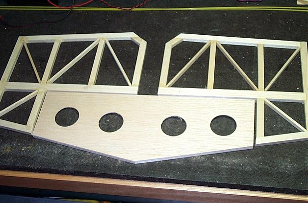

Old 11-19-2002 | 01:18 AM
Joined: May 2002
Posts: 189
Default elev assy
stabilizer w/ elevators. stab is built up 3/16 inch sticks w/ 1/16 inch sheet.

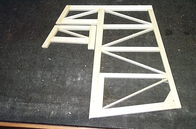

Old 11-19-2002 | 01:19 AM
Joined: May 2002
Posts: 189
Default rudder
rudder w/ mini-fin
