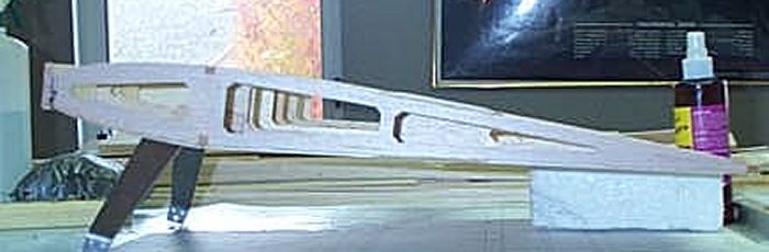

I decided to try a conventional landing gear of sorts on a PBXL. I've had so much fun with the first one, though have dorked it so many times that I've knocked out the landing gear blocks several times. I realize that there is a lesson to be learned here - Don't laugh so hard when you are trying to fly / hover / harrier a few inches off of the ground.
Well I thought that I would try something a little different and install a conventional landing gear block and install landing gear with nylon bolts so they will break away. This way I won't have to give up the laughter!
I thought that I would share my modifications just in case anybody else was interested.
The following is a few pics for your better understanding of these modifications.
PIC #1 Shown with SIG Mid Star 40 landing gear (stagged only)

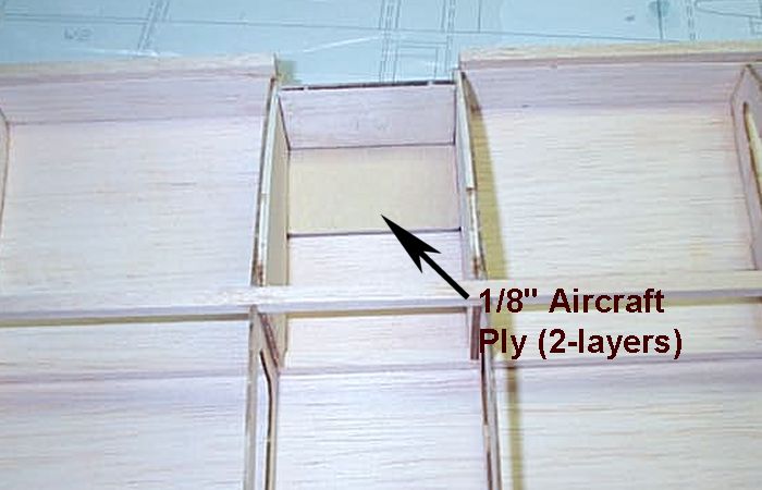

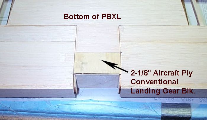

I notched out the 1/8" lite ply nose reinforcements for the 1/8" aircraft ply landing gear block

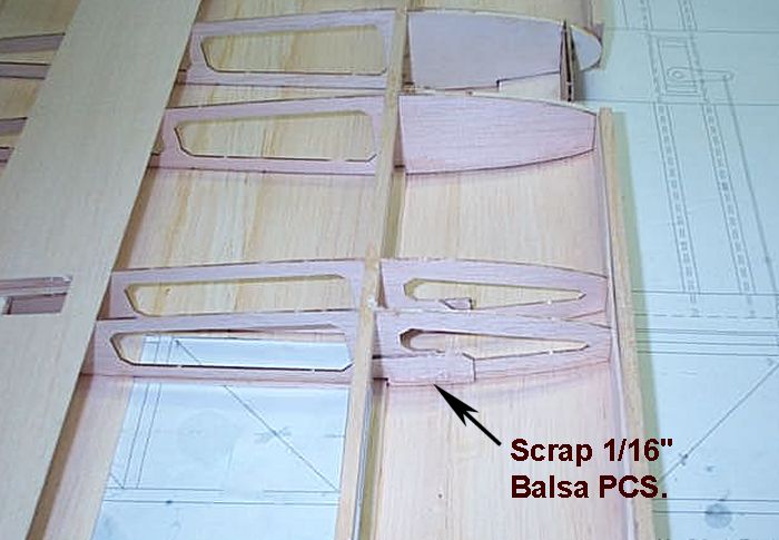

Here is another PIC. I used scrap balsa pcs. to fill in the laser cut notches for the landing gear blocks. I then sanded the scrap balsa pcs to the contour of the ribs as seen in this pic.

OldRCer - I notched the 1/8" lite ply pieces to accomodate 1/8" aircraft ply piece. I then laminated another piece of 1/8" aircraft ply of the same size to the other. The aircraft ply's width is the same as the firewall including the interlocking tabs. I sized the width based on a set of SIG landing gear for a Mid Star 40. I ensured that the LGB was angled forward slightly to make sure that the wheels' axles lined up with the leading edge of the PBXL.
Hope that this helps explain things better.
So far, with everything built for it, no gear, this PBXL is still just under 1/2 lb. I believe that wood selection makes a bigger impact on overall weight over using the individual landing gear blocks with 1/8" wire landing gear vs. this new way with the single LGB and conventional landing gear.

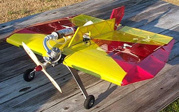

Here is a pic of the modified PBXL. This one has conventional landing gear. I used LG off of a SIG Mid Star 40 that I bent some more to give more prop clearance.

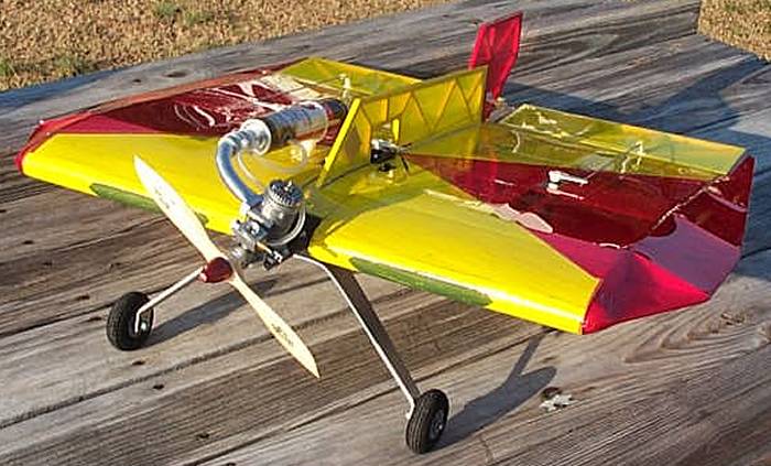

Here is another shot. I used HiTec 225s all the way around, HiTec 555 receiver, 700 mA NiCad Batt. pack. This one is over 1/2 lb. lighter over the original. I contribute the weight lost to the mini servos, more selective in wood selection, and the aircraft ply landing gear block over the hardwood blocks in the original. I have the same engine and moose can as the one that I had on the original (Webra 32 with Mac extra long header with MCM).

This PBXL flies significantly better then the original. I attribute it to its weight loss. I was afraid that the conventional LG would effect its flat spin performance, though did not what so ever! It is more algile, though expected with the weight loss. I still need to program in more expo in the throttle. Its harder to hover at a constant altitude becuase one click of the throttle is too much. It just starts to climb. This is the kind of problem you love to have.

Yes, the prop on my modified PBXL is a modified Zinger 10x4. I would not recommend full throttle on this one at any time. It screams straight up at half throttle The PBXL does not like speed, though was not designed for speed at all.
