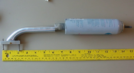

Bigjoe,
Here is a picture I for my moosecan setup on my St90. On this header, I didn't cut any at all at first. I used the full 6" of the header, then my moosecan shown has a 1 1/2" piece on it. I was worried about the header being to short anyway, so I didn't cut off any of the header. But this is for my ST90.
On my 40FP, and other 40size motors,
I take the stock header, and cut 1 1/2 off the back. Then install that 1 1/2" piece into the moosecan. I don't cut and throw away the 1 1/2" piece. So techinally I am not shorting the length of header at all. My lenghts are the same. Maybe I am doing it all wrong. I will go and pick me up some 3/4" pipe this week, and try it your way, because, what I am doing isn't working out the way I want it.
As for the motors going lean, I don't think they are. I think its just the opposite. their going to rich. Because, I am having to lean out the motor untill I almost shut off the high speed needle valve.

By lean I don't mean needle valve lean. When a header and pipe are tuned to the correct size there is a ramming affect that causes the header and muffler or pipe to actually suck the exaust gas out of the exaust port. That is why you will get more rpm and throttler responce. It is similar to supercharging a four cycle engine. The overall volume of the header and pipe together are what is important. Imagine if you plugged up the end of a MCM and header and held it straight up and then filled it up with water. This is the volume I am talking about. You can see that if you cut a piece of the header off 1 1/2 inches you would have less volume. If you used a bigger Mouse can you would have more volume. So if you use an appropriate size Mouse can and you make sure the header is extra long or the big end pipe of the MCM is extra long you then are set what is called rich for the ramming affect. Not needle valve rich. Then when you start cutting the header or big end pipe of the MCM about a 1/4 " at a time you are gradually going LEANER.You keep cutting a little at a time until you QUIT gaining rpm. Then stop right there. Don't make another cut or you will loose the sweet spot where the header and pipe are working great.

Well, I drilled out and straighten the bend on the 6.5 x 1.75" moosecan's stinger. installed it on my 40FP. And I was turning 12,200peak on 11x3APC prop. I then I installed a 10x4APC. I went to 14,100peak. I know have my it set to fly at 13,700. So it looks like my stinger was stopped up.
14,100 on on a 10x4APC insn't bad. Since my OS32Sx on a moosecan only does 15,200. And I can buy two 40FP's for the price of 1 OS32SX. It they still made the 40FP. And the 40FP is lighter to. So if I need another I will go with a TT42.
