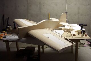

Here is a pic of a new project that fxstbi and I have been working on this winter.It is a giant su-do made of foam.If anyone has any comments or suggestions please let me know.Here is what it looks like so far.

Hard to tell from the pic but how big is it?
Will the foam be sheeted? Glassed?
Motor for it?
Old 12-28-2002 | 03:50 AM
Posts: 135
From: fowler, IL
Default foam su-do
It is going to have a 80" wing and it will be sporting a moki 2.10.
think it will be enough power?I am going to sheet the wings and elevator with 1/16th balsa and the fuse has been sheeted with 3/32 and I also glassed the tail section around the elevator mounting area under the sheeting to help it from twisting under a load.It seems to be very sturdy.

I hope to start mine as soon as I finish the .60 Sudo I'm working on. Todd has been going to town on cutting the fuse and wing cores. I have the fuse core that he cut from pink foam and it looks really nice. He cut the first wing core set the other day and it looked good too. We are using TNT wing tubes, 1 1/2 " diameter x 42" long so we should be good in the spar carry through. Right now it looks like conventional foam and balsa construction. Todd is really doing a nice job on his! With the big Moki's on them we hope to have as much fun with them as the smaller Morris planes and be able to hover and do all the other fun stuff. I'm sure he will keep posting so we can watch progress. Pete

Here are a few pics of the plane so far.Since the pics I have mounted the motor.That moki looks like a monster!!!!

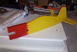

Old 02-02-2003 | 09:47 PM
Posts: 135
From: fowler, IL
Default covered sudo
here is a pic of it covered, but it still needs a few things
