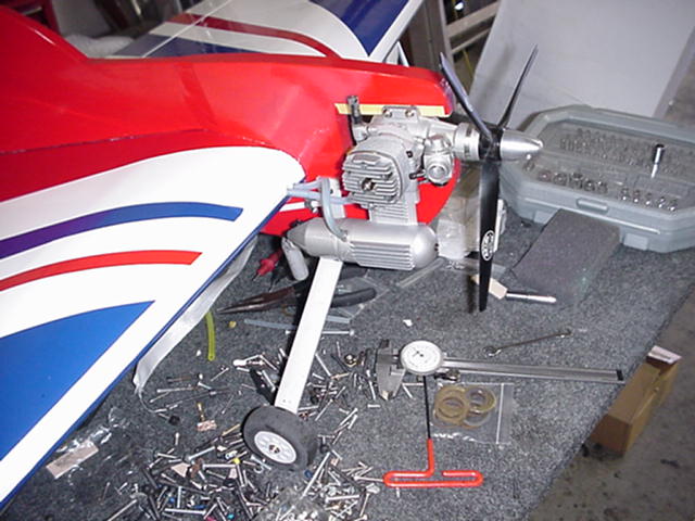

i put a new os 46 fx on on of my morris top cap's and it run's well until you throttle up, it has massive chatter. kinds of sounds like detination. ive raised and lowered the head and it don't seem to matter. the only thing i can think of is fuel. im running 15/20 nitro and oil. any one else had similar problems with this motor.

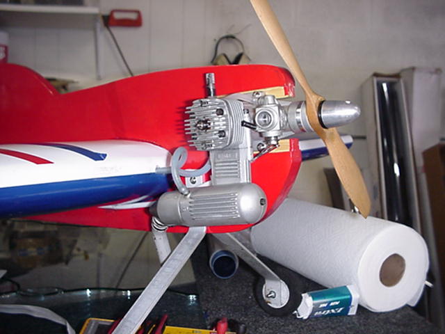

the plug it had was an OS 8. i checked the rod and it has .003 which is ok. i raised the head another .005 and the noise is almost gone, only a little in the mid range. i also changed the prop to a M/A 10X7 3 blade, it don't spool as fast but it's a lot quieter. RR

Dude, is that a tri-blade? The whole point of this plane is the x4 part of the prop. Slow and thrusty is what your going to need. Your plane might start doing the fish dance if you forget you have a 10x7 on there. Run out and get a 12x4 or 12.25x3.75. Then you will have the right prop for the right plane.
