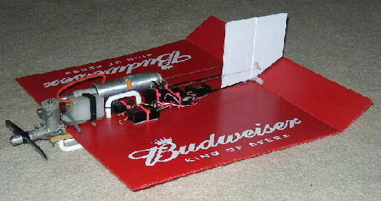

The best PBF ever!

TailSpnr, I notice the stinger on your MCF is bent down. Does it pass through a whole in the coroplast to exhaust out the bottom? I was thinking of doing this but was afraid of stinger hitting the ground and causing a fracture somewhere. Can you explain your setup?
Thanks.

Sure, I turned my stinger down 90 degrees and routed it through the coroplast. To resolve the issue of damaging the stinger I cut it off almost flush with the bottom of the coroplast. I simply use a tie wrap o the top and bottom of the coroplast around the stinger. And I flared the stinger at the end of it to keep the tie wrap from coming off. Its has worked great and the stinger is also the only thing that supports my MCP. And as you can see I have not been real nice to my MCP and its still holding up just fine.
